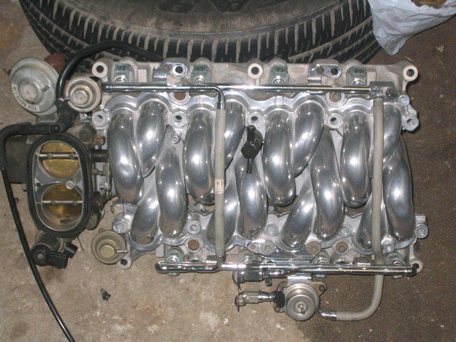

Did you polish the intake manifold? By hand or is that a machined process? What's the outcome of doing that?

I purchased this particular intake that had been done previously. It was radiused and hand polished and then ceramic coated. It is as smooth on the inside as the outside.
Yes, cleaning the IMRCs is self explanatory. Any good carbon cleaner and lubricant with a small wire brush and elbow grease will work. Make sure the mechanism is free. I cheated and ended up taking mine to work and hot-tanked them but they still needed hand cleaning to finish them.
