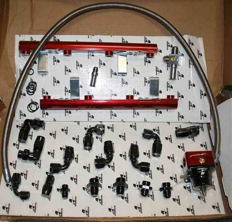

No I'm not. I'm running a return style fuel system, just like the OEM setup. The fuel system past the fuel filter is an aeromotive setup. 98 Cobra rails and Aeromotive regulator. Return Style, not 98 1/2+ Cobra returnless.
Note the Fuel return block on the upper right hand corner of the package.
There is nothing hybrid about it. The fuel pump is the same pump most Mark owners use... The upgraded 255LPH HP pump. Well.. to a degree, it's actually a 255LPH HP Walbro designed to fit a cobra canister, but I've already modified the canister. It ran just fine before the motor was pulled.
As I said earlier, the fuel pump is keeping up with the demand just fine, according to the fuel pressure gauge I have on the Regulator.
