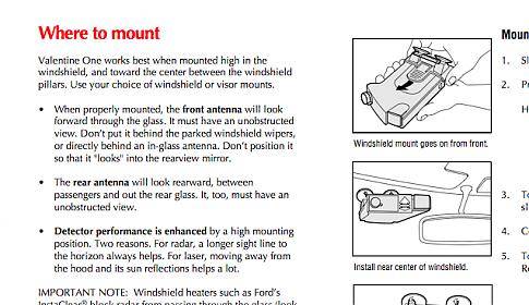

That radar detector aint gonna do you much good mounted that low. Mount it high above the morror but under the tint if possible.

Well.. I don't know who Radar Roy character is, but I do know who Mike Valentine, the Inventor of the Valentine One is. And Mr. Valentine suggests mounting it high.
When Radar Roy comes out with his own radar detector, maybe I'll listen to him.

i my opinion, have the radar where i have it is perfect for me, if i a cop is instant-onning or just has his radar on facing oncoming traffic i can pick up a good mile to mile and a half away. having it mounted low is supposedly better pickup for laser since police aim for license plates(then again if you get a laser signal its already too late, your toast). mounting it too high will block the rear radar antenna from picking up a good signal from behind which is one of v1's major niche's. and mounting it high(unless you have the remote display) got a pain to keep looking up id rather have it in my line of sight. (i usually drive the new jersey turnpike and nj staties dont use laser, i personally hate constantly looking up and having it flash right in my eye) and i dont get how you can even compare an escort to a v1. directional arrows and bogey counters plus a junk radar filter? escort cant even compare

FWIW, Bel also recommends a high mount.

everyone has their own opinions, what is fact it that radar operates off of line of sight, if it has a clear line of sight out of both front and back windows then your good. it is also fact police aim for oncoming license plates and/or grilles so mounting it lower will pick up laser easier. any radar except a V1 doesnt have a rear facing radar antenna because v1 has the patents, all other radars just have rear facing laser detectors, so it doesnt matter where anyone with a bel, escort, cobra puts there radar to pick up radar signals behind. if you put it too high i.e. above your rear view mirror, personally i have notice having an 03+ with a 3rd brake light up in the rear headliner line of sight for the rear radar is diminished on my v1. basically if you want good radar pickup mount it high if you want good laser pick up mount it low, or compromise and put it in between
