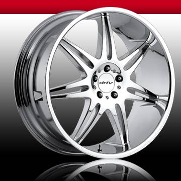

After going through tons and tons of info for the past few months, and talking with many suppliers and other forum members here and elsewhere... I ordered a set of 20" Driv Royale rims and Falken FK472 tires today...

These look sweet! Wierd they have two valve stems though (see pics!) I had them install a flush mount one on the visible one, and they put a regular w/chrome sleeve on the inner. I'm just waiting on the hubcentric rings, and for the salt to get cleaned off the roads a bit and then they go on the car!!!

Well, I put them on without the centering rings just to see how they'd fit...
The center hub of the rim rubs on the caliper bracket badly. A lil finessing of the bracket with a grinder (I'm painting them anyways) and a 3-5mm spacer, they fit (I could have cleared it without the spacer, but I didn't want to take too much off the bracket...)
So anyone thinking of getting these, they will not directly bolt on!

Don't order these rims for a Mark VIII unless you plan on finding and installing longer wheel studs so the lugs have enough thread. They clear fine with the spacers in every aspect but this (and the brake bracket, but thats a wheel design flaw... not a result of the offset.)
I looked around for longer studs, but without making the holes bigger in the hubs (drilling them out with a hand drill is not my way of doing this in an acceptable manner ) to accept new studs, I can't find anything that fits that is about 5-7mm longer...
