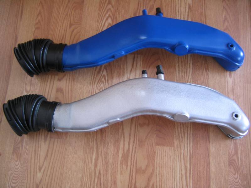

Buy one of these from Thomas A over on markviii.org.
