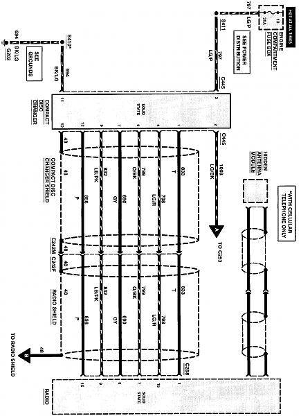

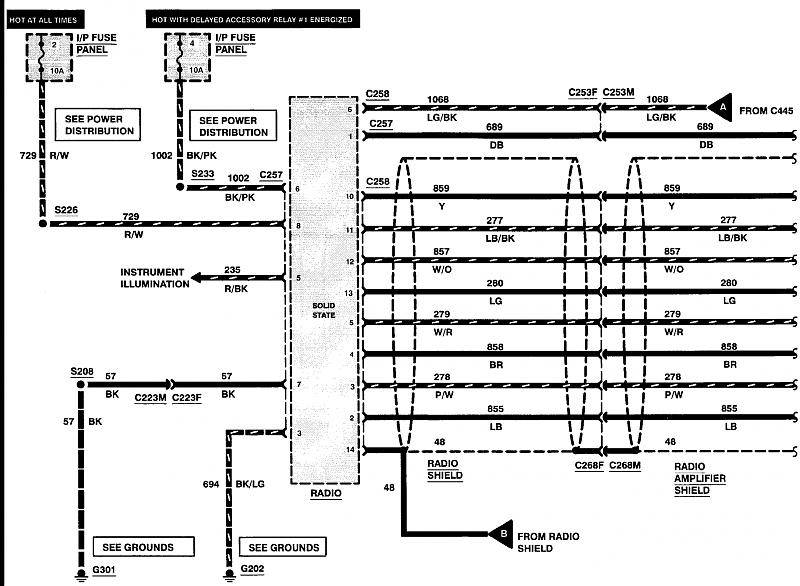

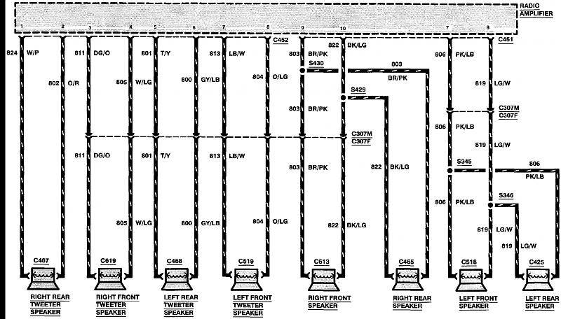

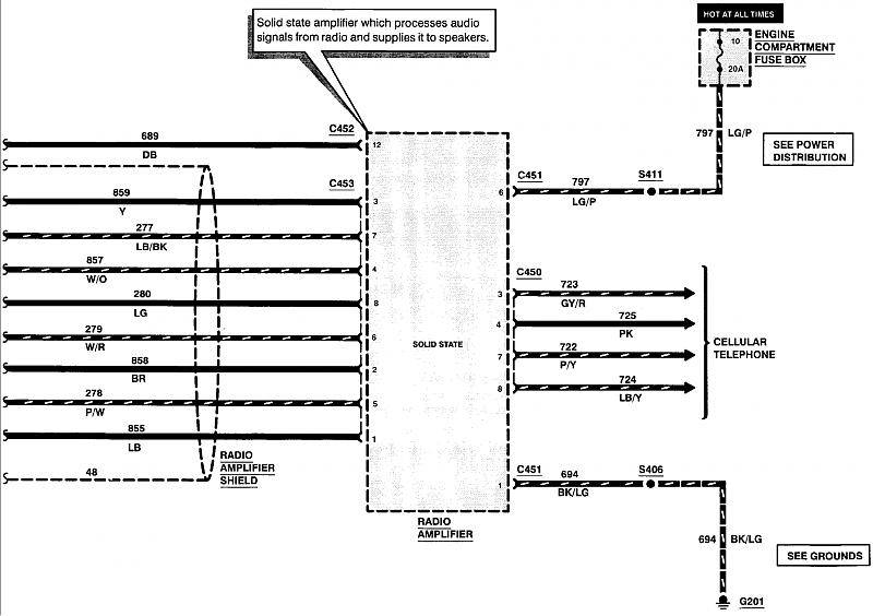

Here you go.
Posted by: Frogman
WTF? Looking at these diagrams, they don't look right.
According to the diagrams, the front and rear speakers are ties in paralel. According to the diagrams, you can't fade front and rear, but I know for a fact that you can.

i never got that, you can fade front to rear, but the diagrams say you CANT
Posted by: Psychostang
The Bass is tied in together, not the tweeters.
Yep, only the tweeters fade. I never noticed until I listened for it after seeing the diagrams.
