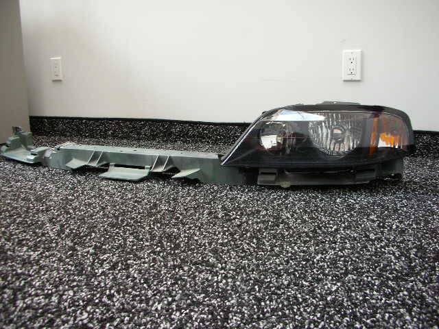

just recieved the 03 headlights and i really need to know what i need to do to install these headlights. I read the posts and every ones has different ways and would love it if some one could help me out. i don't know what to order next. Do i need the headlight mount panel, the 03 headlight harness w/o hid, will the same bolts work and if so how do i connect the harness w/o hid to the 02 harness. I really want to finish this before i get married in march.

I do know you need the 03+ panel but I would think your pre03 harness would work...but I have not done this myself so maybe someone that has done it will chime in

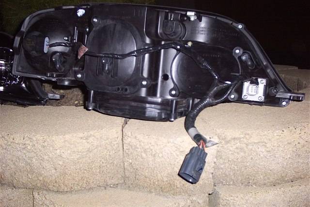

You will have to order a mounting the headlight mounting panel. (im in the process of getting one myself). As for the headlights. I imagine its the same wireing as the HID. With the HIDS I took the Hi-Beam cover off so I could get to the connector plug. I unplugged it from the back and you will have to cut the wires at the plug of the 03+ light.
You take the wiring harness from the pre 03 lights the one with the 3 plugs for Hi,Low, and signal (mark them while you take them off so you know what is what). Cut the Hi off and run it through a hole.(hole that I made to run the wires through the headlight backing. I made the hole right above the connector.) Anyways feed the wires through the hole and soldier them to the 03+ headlight wires. You have enough room with the HI-Beam cover off. Then do the LOW.
Pretty much straight forward the Black wires are for GROUND and the thin red wire is for the LED light. I spliced my turn signal wire to hook that up. After thats all done. Get some silicone and cake up the hole really good so no moister gets in. There are some threads on her with pictures but nothing that really breaks it down. Once you start though its pretty much straight forward.
Sorry for any bad spellign at work right now.
Hope that helps some I have a pic at hope I will post later if you want of what the back of mine looks like.

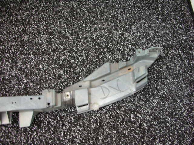

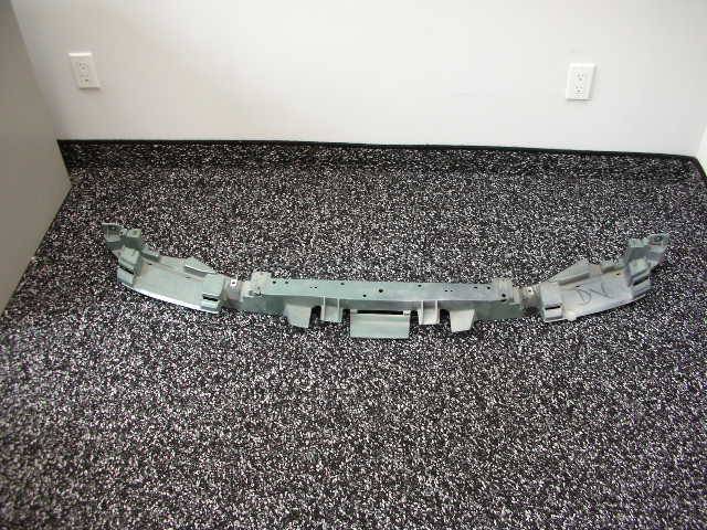

03-06 Reinforcement Bar 3W4Z-8A284-AA
Please note to use the 03+ headlights you must install the 03+ reinforcement bar.
I got this from searching LvC.
Posted by: Flame3g
thanks ken the Part number 3W4Z8A284AA was superceded by part number
6W4Z8A284A. thats for the mount panel if any one wants to know. Oh yeah Ken would u have a spare panel lying around or know some one with one. Just want to see if there are some out here before i order one. Thanks for the info i was just getting confused reading the different threads just wanted some more input on it thats all.
Posted by: GrayGhost1
I had one quite some time ago and sold it. You should be able to pick that panel up for around $130 or so. It isn't terribly expensive.

These are the pics the one with the black taped up wires going to the top of the plugs is what i was talking about before. The harness laying in front of the light is the old harness we are wiring to the 03+.

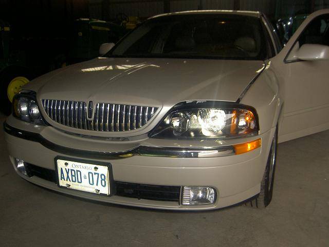

Finally got the mounting bracket for my headlight conversion. It was out of a 2005! Hopefully I get some time this weekend. To finish the progect. Dying to see these HID lights at night.
