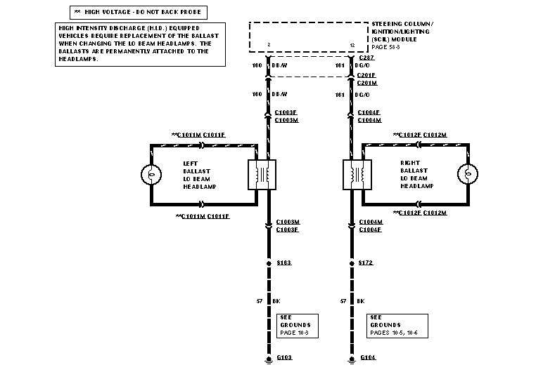

Posted by: chickenviii
Bam!!!!!!!!!!!!!!!

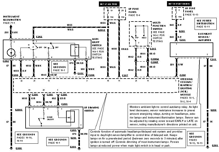

Posted by: lscmkviii
Thanks for the drawing! Could my problem be the SCIL Module? The problem happens even if the main light swich is disconnected. Now only one low beam works!?
never heard of one going bad, and wouldn't want to just throw parts at it, check all of the inputs into the SCIL module, poss the multifunction switch (more problematic on all fords) just get a test light and start probing
