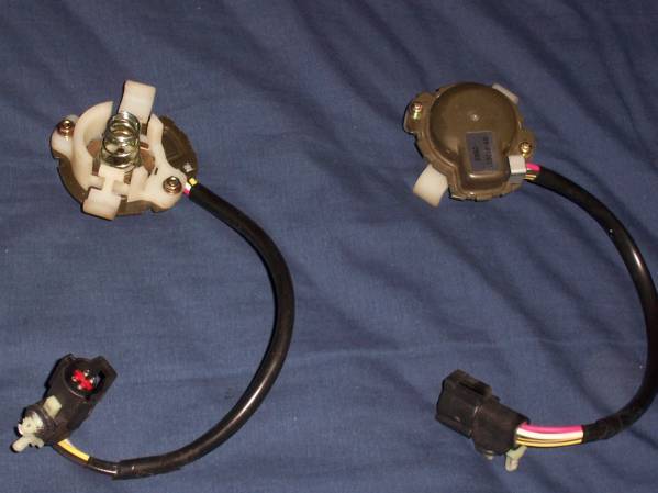

Posted by: stink 'N linc 'N
These are the pieces that came off the tops of the rear shocks.
Im gonna try and disconnect the SDC module and see if that elminates the clickin'
