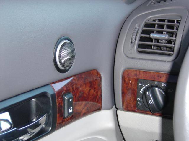

Put em on the front doors like I did. Like this:

i like yours hyelifels but i really didnt want to cut into my side panels like that. you know. i wanted my ls to look somewhat factory but at the same time has the same as an aftermarket car or what a person do to theirs. you understand what im trying to say. but thanks for the advice and yours look real clean. whoever did it.
Posted by: HyeLifeLS
I did the install.
Well, as I am going to sell my LS soon, I removed all the aftermarket speakers except the tweeters. I connected them to the stock speakers and they sound real nice.
I didn't take em out so I won't have an ugly hole, also those Infinity tweeters match the color of my interior really good, so if someone wouldn't know, they would think they are stock.

Posted by: 2001LS8Sport
They really do look stock. That is a very nice installation.

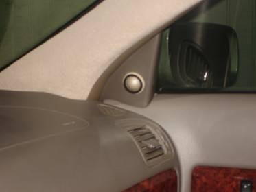

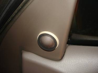

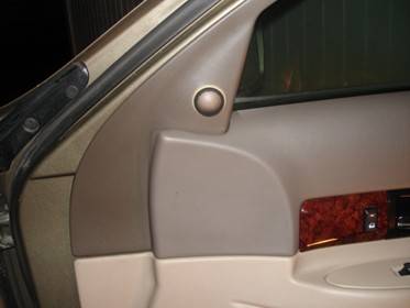

I put the infinity reference tweeter on the piece of molding that covers the sideview mirror. I very carefully used a hole saw to cut the circle. The whole was close but needed some sanding with a rounded file. It was flat on one side with a curve on the other. Once the hole was big enough, I was able to press-fit the tweeter into the molding. The bezel was painted with some Duplicolor interior panel paint to color match it to the interior. Looks factory.
As far as placement for 2 sets of tweeters (I am assuming 4 tweeters), I'd place them by the side view mirrors, like I did, and by the woofer in the front door as jdsimons had done.
