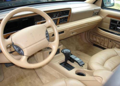

Sorry to jump off topic here guys but, the 94's console shifter is supposed to light up to tell you your current gear?
Mine doesn't and it drives me nuts. I just want to clarify, is it supposed to be back lit? If so, how would I replace the bulb/led?
Thanks guys.
Posted by: ketyokeinnor
let see, I'm assuming you don't need to pull the whole console, that would be dumb on ford's part.
From the attached pic, (borrowed from LincolnsOnline) I'm guessing that black plastic part at the base of the shifter somehow comes out/lifts up.
