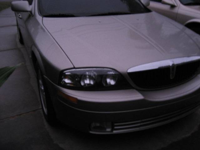

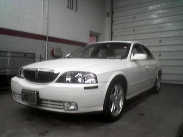

well i got the headlights from akord98, i resealed the out of them. jus went to the carwash, boom mostuire in 1 opf them. i used 2 tubes of permatexc high heat rtv. let them sit for a whole week. heres a pic from before i washed it. also. i heard drilling holes in the bottem any ideas????

that looks really good... i love white ls's, im actually thinkin of doing mine a metalic white

thanks, i also spray tinted the lenses on the bumper ahwile ago.

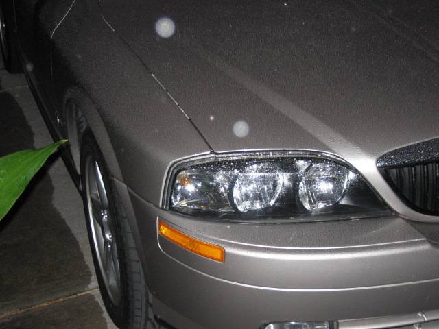

ok i'll throw this out here. bought these from local member on here yesterday and threw them on, kept originals for quick back to stock, went with the cheapest sylvania regular long lasting bulbs, not the silverstars look like a metallic green blue orange reflection. now an lse grille.

yeaaaa them bad boys look nice. i wonder who you got those from??
