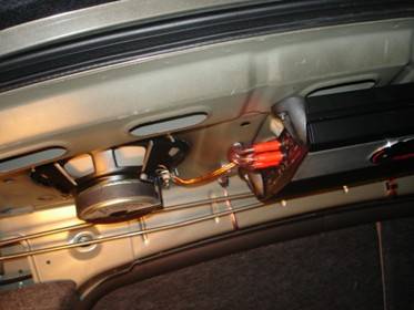

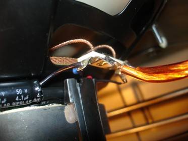

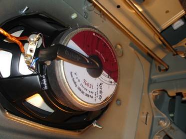

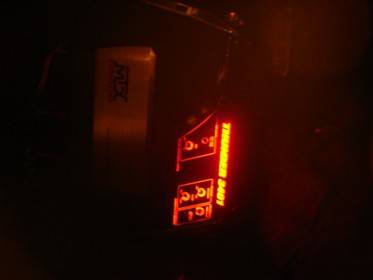

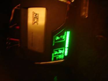

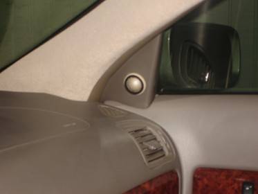

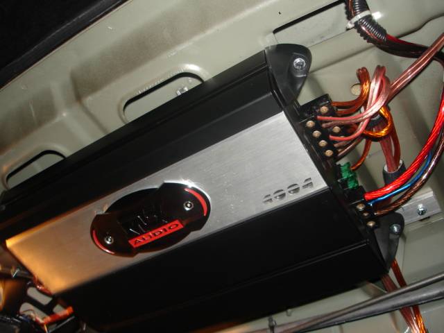

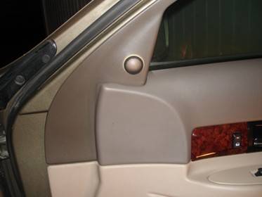

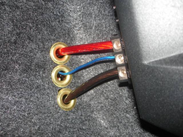

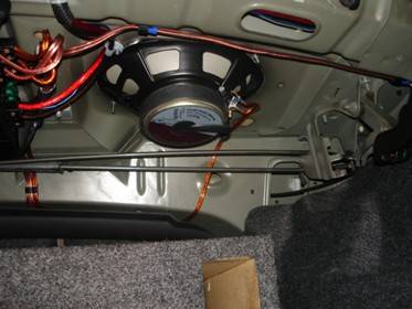

Yes, I have. I recently upgraded the v8 ls sound system. Sounds incredible. Liked the factory look so I kept the deck. Upgraded the front speakers to 6 inch Infinity Reference Components powered by factory radio. The factory tweeters on each side of the middle console are still in place and functioning also.Rear door speakers were upgraded to 6x8 Kenwood 2-way. Added 6x9 Infinity Reference 3-way to the rear deck. The four Rear door/deck speakers receive power from a 4-channel 400 watt MTX amp which is mounted under the rear deck in the trunk. A single 12 JL audio sub resides in the trunk powered by an MTX 2channel 300 watt amp run in bridge mode. It is mounted in the cubby hole on the rear right side of the trunk. I took my time and stripped the whole interior out except for the front seats and dash. All new wiring was run from the amps to speakers. Speaker lines were run through the factory rubber boots for the doors. All speaker connections were soldered. I absolutely loved that the battery, an Optima yellow top, is located in the trunk. Believe it or not, it took me about 5 days, working a few hours a day, to complete the project. One thing that slowed me down was cleaning every part of the car that I had pulled out. The Armor-all Orange wipes are fantastic. With enough elbow grease, it will make whatever part look brand new. I took my time and have a lot of pride in my work (and the car) to do it right. I also ran a line level converter from the rear of the factory radio to the "hi" amp. The line level converter resides in the glove box. It has gain controls on it so I wanted to be able to access it easily. I only had to run one set of RCA's to the back of the car and of course the remote line. The "hi" MTX amp has an output that utilizes RCA's to send the signal to your SUB amp. The neat thing about the sub amp is that it has a remote gain level controller. I have the controller knob mounted below the traction control button on the center console.
There are holes on the rear deck for a couple of 6x9's. I had to "persuade" the sheetmetal to accept the speakers. I used a rubber mallet. It worked out well. I could have just mounted the speakers from the underside of the rear deck, but wanted the speakers to "sit" in something vs. "hang" from something. Have fun and take your time to do it right.

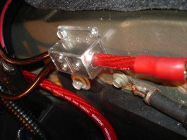

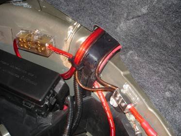

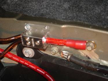

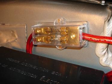

The stock battery terminals WILL fit the Optima Yellow Top. As far as any kits, if you are referring to how I got power from the battery to the amps, I used a fused distribution block. I used a ringed terminal at the positive post of the battery. There is a 4 gauge line from the battery to the fused distribution block. This box contains 2 fuses and splits the power to 2 8 gauge lines. Each line runs to its respective amp. I'll work toward getting some pics of the finished product tommorow.

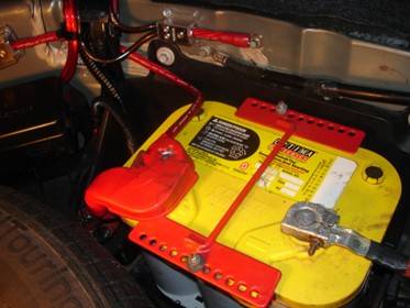

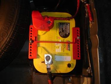

im actually talking about how did you get the yellow top to fit in the stock battery mount. or did you tie it down somehow? can you show me a pic of how you have them in? thanks.
Posted by: kedaigle
[quote=nortyhat]im actually talking about how did you get the yellow top to fit in the stock battery mount. or did you tie it down somehow? can you show me a pic of how you have them in? thanks.[/QUO
I had spare parts from some of my past vehicles. The red tie-down came from Advanced Auto. If I remember correctly, it came with two metal rods with hooks on one end and threads on the other. I had to modify the LS's factory battery tray by drilling it out to accept the hooked portion of the rods.
Here's the pics of post installation.

Great install on, looks great. Did a good job with wire management there and kept most of all your trunk space .. i like

hey kedaigle did you upgrade your alternator guage wire? thats what it look like. does the power wire from your alt to battery run under your car or through the side panel like where your door step is?

No. I did nothing to the alternator line. I used the factory electrical line guides to run the both of the amps' power and ground lines. That definitely helped in keeping everything presentable.
i'll look again to be sure, but i do recall there being a large gauge line along the passenger side door sill. It was run in the same guide as other lines, just in a seperate channel.
