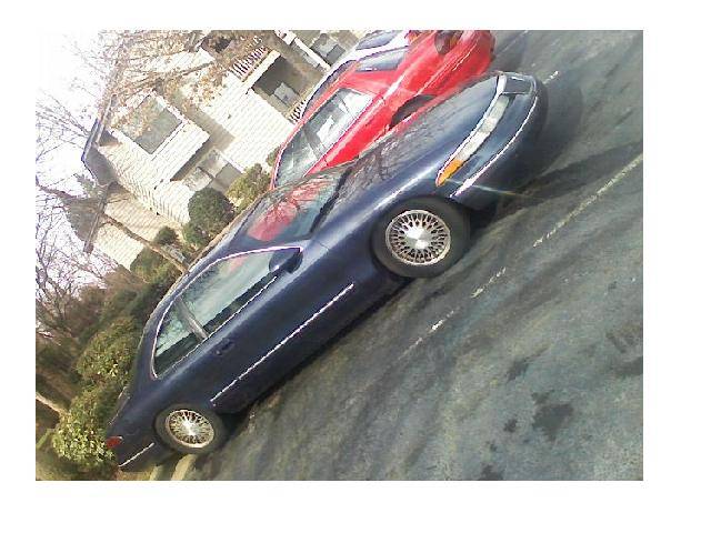

Posted by: 94BLU8
ill post some pictures when i get back from that cold stat of minnesota on febuary 3rd 2007 k

Quote:
Originally Posted by LSCGODDESS98 View Post
any pics..let see!!!!
