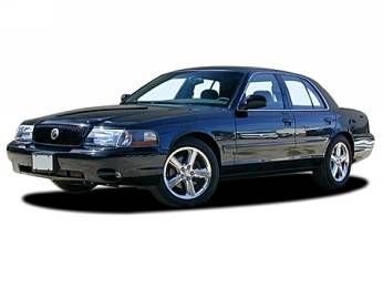

Posted by: evillally
You can swap a set of DOHC heads... but why not just buy a Mercury Marauder?
All DOHC heads are about 52cc (PI 2V= 42cc). The Marauder is 10.2:1, same as the Mach I heads. Just FYI; you'll be using premium fuel anyway if you put those heads on a SOHC. You'll be pulling 10.5:1 with Terminator heads on the Town Car's block (Terminator heads = DOHC on 03+ Mach I, Marauder, Cobra)
As I've said, you might as well buy the Marauder; or upgrade the drivetrain on the TC...
