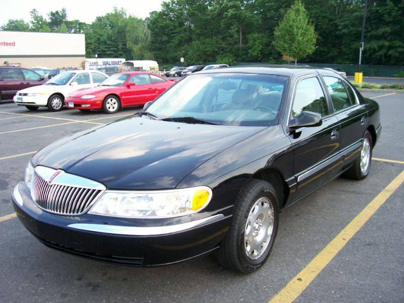

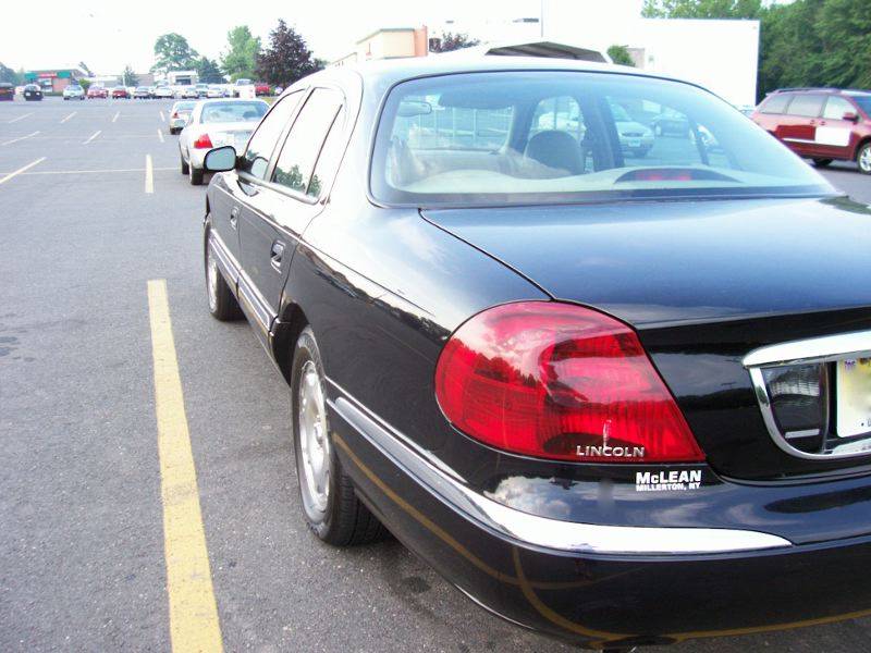

I'm 19 & I love it too. In terms of HP I don't want to go too much over since I have a 2001 and 275hp is enough for me, maybe a K&N filter, but deffinitly I want to but some Mufflers that give some more Growl to the Car, not too loud ( I mean Marauder Loud ). I want to keep the car as stock looking as possible, I would take the Exhaust tips from the Factory Mufflers and put them on the New ones. In terms of Rims, I Like my Stock Rims. For some reason aftermarket rims don't appeal to this car for me.
I would put a Xenon HID kit to the Lights. I'm not a fan too much for tinted because it makes me feel like I'm in a punks cheap riged Honda Civic.
These rims look great and Shine like Chrome if I polish them, I can NOT imagine putting 17's or 19's and some spinners too, that would ruin it. Plus, with the Factory Rims, you would continue having the Supurb Smooth ride of a Lincoln and Kepp it's Luxury Appeal.
