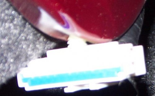

can you post a picture?
Posted by: MDavis0424

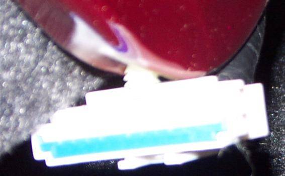

Attachment 22811
Not a great photo I'm afraid. Looks stock, wires are wrapped in cloth tape like factory harness.
Strange place, since the connector moves with the hinge whatever plugs into it would need a lot of free play, unless its actually fastened to the trunk lid.
I counted 11 pins all in a single row.

Sure looks like a factory connector to me. I'm not sure what that's for. I would be interested in knowing.
Posted by: SoonerLS
I just looked at a picture of my '04's trunk that I took just before I traded it in, and I see the holes in the hinge that would accept such a connector, but there's no connector (my '06 doesn't even have the holes). The size of the cable in the picture above looks like it's close to the correct size for the cable that runs from the Visteon (Ford/Lincoln) Sirius adapter to he head unit, but that connector is definitely not a part of the standard Visteon harness--I had it in my '04, and I have it in my '06.
It could be a Molex or FoxConn connector, but I don't think it's Lincoln factory. FWIW, the Visteon (Lincoln) Sirius unit isn't factory, either--it's a Dealer-Installed Option. The underside of the deck lid would be a decent place to stash the Sirius receiver, though, being out of the way and allowinf good ventilation. Maybe that's where a previous owner had it mounted--but I'd expect to see the Sirius antenna on the roof if that were the case.

thats a good one, it looks factory. If an LS comes in so I can see where it goes I might be able to figure out, but the wiring diagrams really dont list anything in that area with an 11 pin connector. As far as I know all the sat radio stuff goes inline behind the radio.
