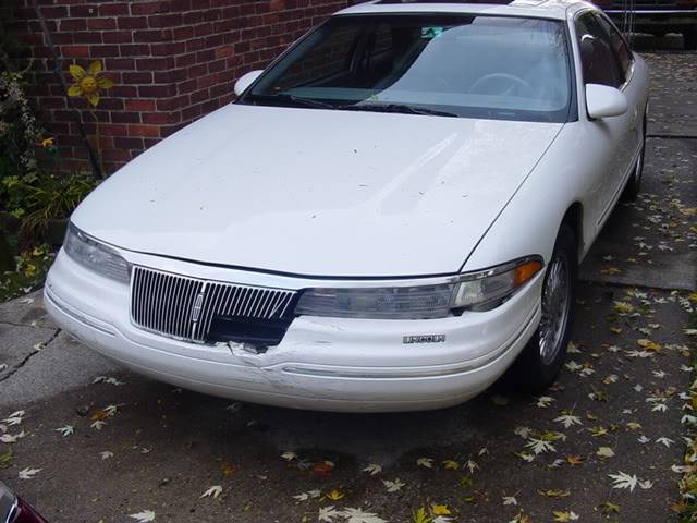

thanks guys. Heres the damage. Only thing wrong with the headlight is the top fastener/adjuster that just broke off. So it looks like ill be riding ghetto for a while till money for the bumper and grille come.

Anything metal should be 'frame pulled' at a body shop. Shouldn't cost more than 2-300 unless it's a large city, or they're raping you.
Header panel you definately want a mark viii of course.
You can't use any tbird parts.
It's really not that bad. I've had a mark look alot worse than that and didn't have to replace any of the structure.

That looks like it would be about $1500 at the body shop I use...... but they do DAMN good work.

It's hard to tell in the picture, but looks like the metal bumper support may not be damaged, even if it is a bit you could just replace the bumper cover , since the metal one is just for protection and support.
The cover easly unbolts just many screws!!

sorry to hear that, at least the damage is not all that bad.
Posted by: driller
Sorry to hear of your bad luck.
Damage doesn't look that bad, you got lucky. Usually a good smack in the front pretty much totals these cars as far as insurance is concerned.

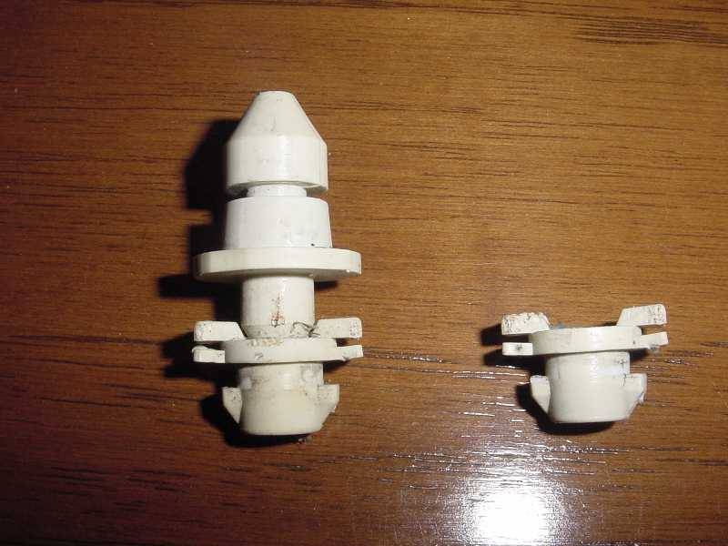

Is there any way that you could just get me the white piece that holds it to the header panel. Thats all i really need right now.

Do you mean this part?
If so, I can't help you.
Just kidding. I pulled the old headlights out of the garage today. Out of 4 nasty headlights, only one had the white mount that wasn't broken off. They are tricky to remove so I took a broken one off first to make sure I could do it (the one on the right).
Someone told me that you could buy replacements for these. I'm not sure about that though.
You can have this one if you want.
Posted by: MarkVIII93
Thanks Bill. I have it ghetto tie strapped on for now. It will keep the headlight up instead of at the ground. How did you go about removing the clip? i just popped the ball out of it and fed the strap through.
Posted by: billcu
Those clips are a pain too. I just use small needle nose vice grips and a hook tool or a screwdriver to unlock them.
I've heard that there is a special tool but, I've never seen one.

Convertible Internal & External Snap Ring Pliers ...
Use the 90 degree angle tips.
