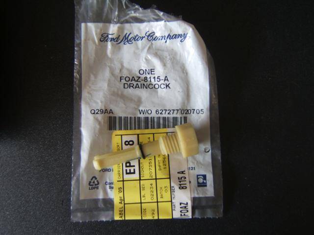

where is the draincock located? Call me stupid --- I can't find it. I've read the tech article, but it does not show where the draincock is on a 2000 LS V6???? PLEASE help
Posted by: Quik LS
it's right in the lower passanger corner - it's a white hex keyed plug. You only loosen it enough to allow the coolant to drain out of the pipe just above it.
Posted by: BatMobile
When replacing be very careful. I had to buy a new one last time because I over tightened the little plastic bolt just a hair too much and it broke.
Posted by: hhoganjr
Is it in the front or the back?
Posted by: Quik LS
? not sure what you are asking...
it's in the bottom of the passenger side of the radiator... at the front of the car.
Posted by: Quik LS
Quote:
whew - I'm not the only idiot.... lol
Posted by: JES_LS
That is not as frustrating as breaking one when you are trying loosen it to drain the rad. I had two break in succession on my mustang gt. The third one I put a little anti seize on the threads and sealing ring, so it will release with less effort.
