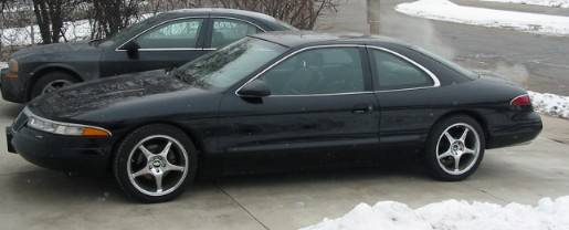

Posted by: 02LSE96LSC91SE84TC
1996 LSC
Performance Wheel Outlet (Out of business)
Y2K Cobra R
18"X9.5"
36mm offset
BFgoodrich
G Force KDW
265/40/18
Had to roll the rear quarter edges for clearance, fronts rub the inner fender plastic when cranked.
