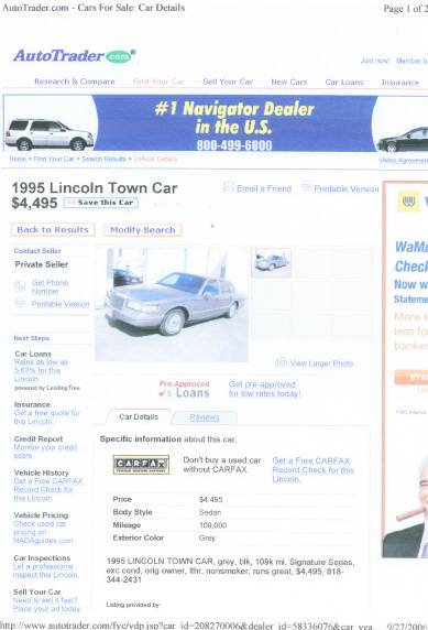

I am considering buying the '95 Town Car (Signature Series) in the attachment. Gray with a dark gray interior.
It is at a car detailing shop- the owner of the shop is selling it for his brother. As the ad says, the car has 109,000 miles and is well-kept. I couldn't find any dents on the body and the seats have no tears. Everything seems to work; A/C/heater, power windows/seats, radio, etc.
The asking price in the ad is $4,495, but a for sale photo of the car in the shop says $4,299.
The owner has the maintenance records. Work done in 2005: Some front suspension parts (pitman arm, idler arm), water pump, rear suspension checked (light went on). New brakes in 2004.
I did a vehicle check and it comes out okay. No salvage record or anything like that. I did drive the car and it feels fine. Quiet, smooth ride, no hesitation. Starts right up. The battery is getting old (dated 5-01 if I read the code right).
So I'm still deciding. Maybe I'll make an offer of $4,000.

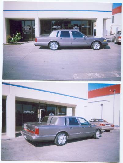

Well, I bought the '95 TC I was looking at! Photos below.
I made an offer of $3,800 and the seller accepted. I took it to a near by shop to buy a battery. The mechanic said the rear air bags are okay- they stayed fully inflated. The CAS light was coming on a few times last week but hasn't in the last 4 or 5 days. He thinks it may be the sensor or the computer itself.
I'm really enjoying the car. Runs and drives great, nice leather interior and the fit and finish is very impressive. Two of my Cadillac friends saw it last weekend and also liked it. One of them couldn't believe all of the gadgets and power-operated items the TC has (his newest car is a '75 Eldorado Convertible).
According to the computer readout, I've been getting 17.8 mpg driving on surface streets and 24.3 mpg on the highway. About what I expected.
