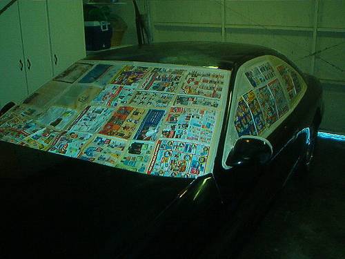

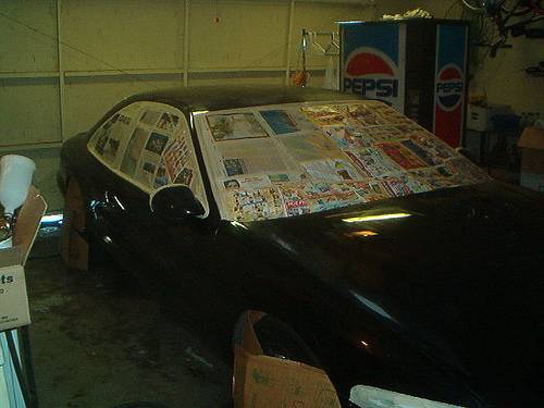

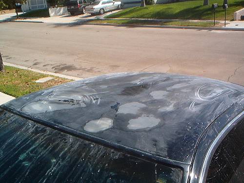

I painted the lincoln yesterday, started prepping at 8 am and finished around 9 pm. Took it out today and started color sanding all the orange peel and runs out of it. Man painting is alot of work!!! I am exhausted, my back hurts from leaning over the car for two days, and I am still not done color sanding. Here are some pics of the process-
started sanding the sun damaged clear coat and prepping the car.
perfect way to recycle junk mail!

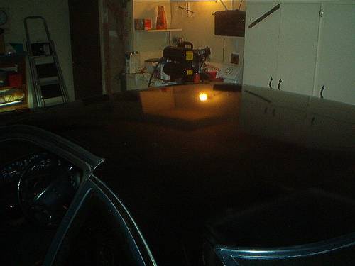

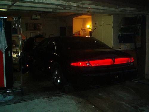

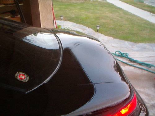

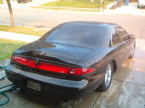

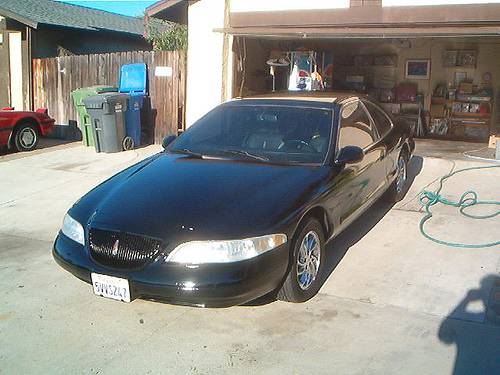

Now the finished product, keep in mind that I still have alot of color sanding to do... But I don't think it came out half bad for my first paint job and with the space and materials I had.
no more chunks of clear coat missing!!!
looks like glass!

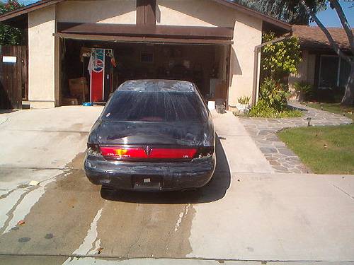

aired out and getting ready for a bath.

nice, any close ups, if you put alot of clear on you can wet sand it til it looks perfect

I will have to take some better pics when I get my good camera back. I have been wetsanding and waxing all day today and i only finished half the car. Man it is alot of work and I had no idea. The paint did not come out perfect so I will be working on it all week to try to take out any imperfections

Yes I painted in my garage, I preped the garage before I even preped the car. I swept the floor, hosed it down and cleaned it pretty good. Then before I started to spray the paint I pulled the car out and wet the floor again to keep the dust down.
