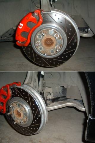

I have just found something that might be what I want
This picture is slightly wrong, the rotors for the LS only has 6 rows of holes between the slots. They also come nickel cadmium plated with is supposedly better than zinc. This company drilled them them selves from brembo blanks, this isn't preferable but I think most of these companies do that anyway.

You think your last set of cross drilled rotors didn't last then the ones with more holes will last even less. You weaken the rotor quite a bit when you drill holes in the rotors and they will crack easier. You won't see much benefit from rotors that have excessive holes than ones that don't unless you are an extreme racer or autocrosser. Remember, race cars change out the rotors after every race.
I don't know what you are trying to accomplish other than it "looking good". I have the StopTech Big Brake Kit on my car and they only have slots in them. StopTech's website even goes into detail about cross drilling and they don't recommend it for daily drivers.
