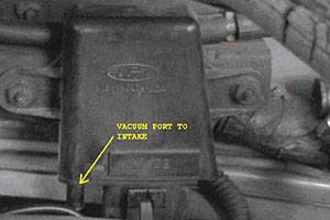

Someone told me MAP sensor. Does a Mark VII have a MAP sensor? What does it do? Thanks so far for the help guys.
Posted by: NYC LS8
Well, if the vacuum line came off the MAP the car would idle like it had a big cam in it and would run rich.
It's on the firewall behind the intake and looks exactly like this:
Posted by: Ronbo
Wait till you hear this!!! I unplugged the vacuum line off of the MAP sensor and it runs infinately better. It doesn't idle funny, miss, or anything. That is, of course, sealing off the loose line also. When I plug the line back in, it runs like crappity crap again. I think thats my problem. Is there anyway to double check my findings, or is common sense obvious here??!!!
Posted by: Ronbo
After a little more thinking, I changed the MAP. It runs great now. I just need to reset the timing again and I think the car will once again be perfect!!!
