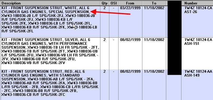

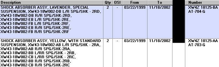

Posted by: TeamFord
Below are the descriptions for both front and rear. The fronts are the real tough ones. The Motorcraft number is the short # of the 2. I blacked out the MSRP so I don't step on any toes.
Posted by: mrzeee
these are the fronts
the std susp is a red #1W4Z-18124-AA or ASH-149
the spl susp is a white 1W4Z-18124-CA or a AST-26
the perf susp is a silver 1W4Z-18124-EA or a ASH-151
these are the rears
std yellow XW4Z-18125-AA or AT-703-G
spl lavender XW4Z-18125-BA or AT-704-G
And this is a partial listing in the ford catalog!!
