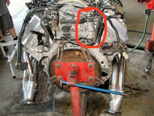

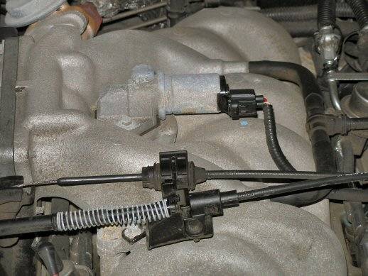

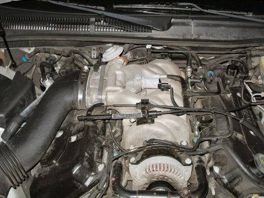

Posted by: chickenviii
hold on gen 2 brother ill go look
the first pic is a close up its the thing with the wires and 2 bolts holding it on and the second is how u see it as looking at the eng (now all the gen 1 guys will be jealous )
