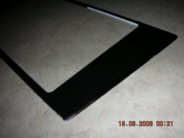

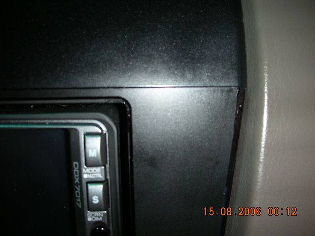

The place that I got my tv intalled at, put a cheap face plate that looked like crap. Anyways we have a plaque cutting machine at my work and black faced plastic. The plastic is .062" thick and I measures my opening. The machine cuts a little angle but not enough to blend in from the air duct to the temperature controller. I used a razor blade and shaved a little more to blend it in. Looks 100 times better then before. I had to use a sharpie marker to colour in the white around the edges. If anybody wants one made let me know.

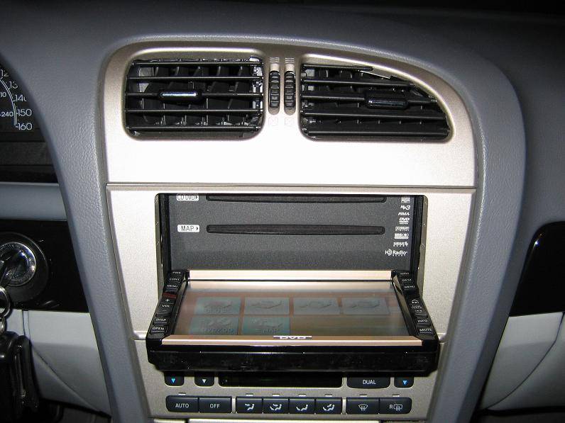

Posted by: NVMyLS

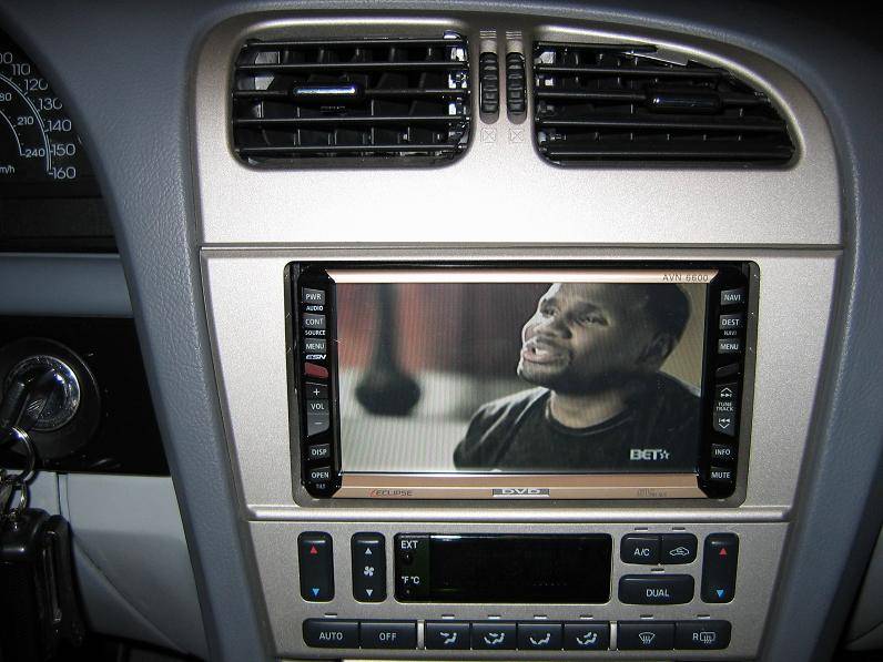

Here is my Eclipse 6600 with the factory navi bezel. I had the 5435 but didn't like how you couldn't watch DVDs and navigate at the same time so I upgraded to the 6600 and love it. It looks really good in person, the pictures don't do justice. I was able to get it to fit like it came stock with the car.

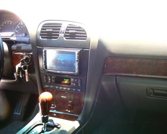

Posted by: Flame3g

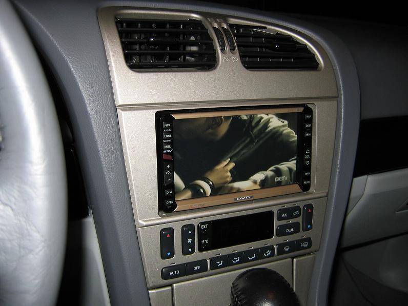

I used the nav bezel and mine came out real good
Attachment 21011
Posted by: LennDawg
hey FLAME, what did you use to paint the nav bezel black?
Posted by: Flame3g
i used a universal flat black form auto zone i plan on getting the wood kit for some places in the car ext: temp con, vents
Posted by: DragonDesign
Hey NVmyLS,
How much empty space is there between the side of the actual unit and the side of the trim piece? I'm looking for as little empty space as possible. From the pictures it looks good top and bottom, but the sides may have more space than i would like, but I may just be looking at the pictures wrong. Yours looks really good, I'm just really picky.
Posted by: NVMyLS
Like I said, pictures don't do justice. The spacing to me is just perfect and I'm very picky also so I would recomend using the factory nav bezel. I made many templates out of abs plastic and the factory nav bezel fit the best
