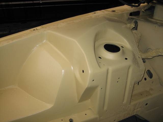

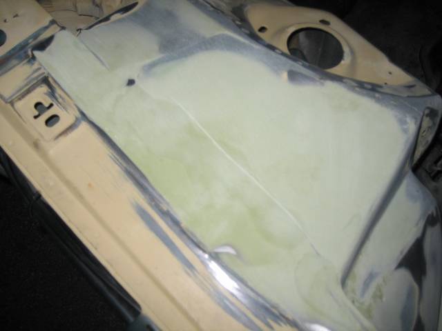

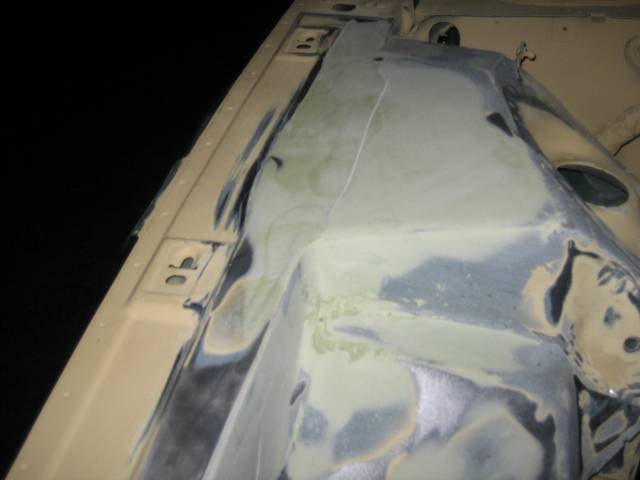

OK I've been working on my engine compartment all day shavin her up and 7 hrs in to it I get a call from one of my Mark brothers who needs a hand installing Gen 1 HID's. So I needed a break from all the sanding and sanding and sanding and sanding... and then sanding, so we start rappin about this and that and he comes out with a piece of LVC info that i was a virgin to hearing. Now my bud is no regular LVC rookie so I rarely ever question what he says but I was told that a gen2 front clip will bolt up to a GEN 1 !!!!
My original idea was to modify gen 1 fenders to fit a gen2 header panel and headlights. But now i hear I may be ablt to bolt it up! Please if anyone knows any real solid info on this, no should or coulds, please let me know.
Here is some of the latest pics, its my first shave job so if you have any suggestions they are welcome. Thanks for any help.
JJ

you will have to replace the entire front end to make it work. I would like to do it someday tho. I would rather have a gen 1 front end with the gen2 rear.
BTW.... is that filler on top of paint? No good.
Looks good other wise.

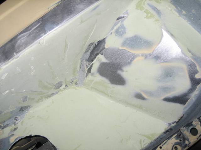

No that is not filler on top of paint. I first filled the entire area with long strand glass then filled the underside with the same. Next I tore down the glass to shape, then filled with filler. I tore down the paint prior to all this and put in primer. Today I should have 1 side in primer complete the other almost complete. Ill post pics tonight. Yes I agree I liike the gen2 rear as well. But i am looking to do is solve the ill lighting issue up front and what better way to do it than doing a one off custom swappins! Now I am very interested in preserving the bold and beautiful body lines that make a mark, but want to research my options. I am going to test fit a gen2 fender later today, Ill post results. Thanks JJ
Theres a ton of movement and flexing in that area. I can see this being a cracking pita in the future.

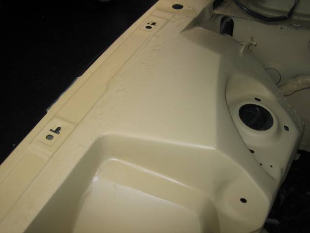

Posted by: ASMBLYLINE
almost ready for paint

That quote was mine, not SEANKLSC's,
I brought that up, because it looked like you were slathering filler over paint. I never said that I underestimated you. I have a "little" bit of expierence in this field and have done the very thing you are doing now. But to be honest, you should'nt have glassed' over those holes.
They should have been welded, ground down, and then putty'd over. This is my project 95' that i completed about 2 months ago.

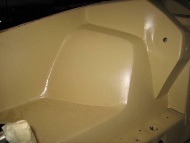

Finally got some progress recently and finished the shave job. During this time I also prepped and bedlined my k-member. The Bedline looks good and seals the metal real good and way easy to keep clean. So after experimenting with custom porting on my primer gun and some thinning I was able to spray the stuff. I liked the end product so much I decided to bedline the engine compartment. Im looking forward to seeing the shiny engine gleamin int the tuff bedline. Whats every one think. Most people who havent seen pics hate on the idea but I think its serious..
