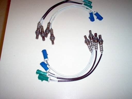

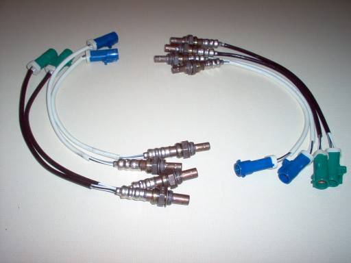

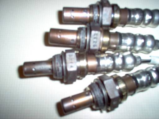

Posted by: MonsterMark
Quote:
Originally Posted by Iwantmymarkback
Honestly dude, I just bought all four 02 sensors, and now i look like the moron. Thanks a lot for everyone else who really HELPED me. You really should have said that before hand when I asked the first time instead of just saying yes you have 4 o2 sensors. Now I look like the dick.
Or I can really help you look like a dick. j/k
I posted this the other day so a search on the LVC may have revealed this info to you in a timely manner.....
On the Corral there is a guy selling them for $70.00 shipped for a set of 4.
http://www.corral.net/forums/showthread.php?t=809019
Just got mine today. Bought 2 sets. That is why there are 8 shown. Haven't installed them yet but I now he has only 8 sets left. I just bought another set for my Expedition a couple of minutes ago.
Again, I haven't installed them yet so performance (or even if they work for that matter) is an unknown.
