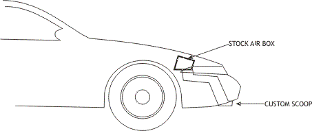

I've done some research on the subject of air induction, and there seems to be many who question the benefit of converting to a conical filter. I was contemplating replacing the standard filter with the equivalent K&N, but after researching it, I'm not sure if it's worth the extra dough. However, I've examined the stock intake system, and have a question. Has anyone extended the tube that goes out the back of the air box to the front of the car to a custom scoop under/in the bumper cover, so it's actually drawing air from outside the car? Pardon my crude sketch - but something like this:
I was thinking you could get one of those cheap fake scoops that people usually just stick on their hood to try and make it look bad when it ain't. Anyway, get one of those, paint it body color, cut a hole appropriately in the underside of the bumper cover and run hose to the stock box. The way I'm thinking about it - it would barely be noticeable from the outside of the car, but potentially highly functional. It would kind of be like the scoops they put on the 68 and 69 4-4-2 Olds cars - but in the bumper cover instead of all the way underneath. I know this is a simplistic description of the modifications that would need to take place, but let's just roll with this in "idea mode" for now.
Has anyone tried this before?

In your drawing you show the intake way too low on the car. Just dying to suck up road debris and water. If it was placed at approx the same height as the original position and placed behind the grill, the intake would make more sense.

I agree w/ MonsterMark on this one about the scoops location. It would be bad to pick up slush and leaves in the intake track. Not that it would totally choke the air flow, just a pita to clean out.

You could put some type of screen to prevent any type of debris getting sucked up. Also to drain some water, you could possibly drill small holes toward the top of the scoop near the air box...

That dude's car is pretty much what I had in mind with a few exceptions. One, I was planning on keeping the stock airbox, and running hose to it from the ram air port. Two, the square opening he has isn't very aesthetically pleasing to me. This is why I was planning on going a little lower with my opening, and probably a more flat oval shape, if not prefab scoop of some kind. But basically - that's it.

Which is fine if you ignore the fact that an air filter becomes SHARPLY more restrictive the dirtier it gets, making you lose any horsepower you might have possibly gained within only a few hundred miles of installation.
There is no reason in the world to pull air from that low on the car, and on summer days, you'll actually be incresing the amount of heat going into the air intake at low speeds, because the temperature that low to the ground is often higher than at grille height.
Also, please consider the internal resistance of these tubes. Back in the day, Oldsmobile found that they got more horsepower and more airflow from just gathering air through the hood than running 2 large tubes down to the front bumper.
Your best bet for horsepower is to make it so that way massive amount of air can reach a cone filter mounted as close to the throttle body as possible without being exposed to engine/radiator heat.
The best bet would be to just have a cone filter mounted somewhere where the air compressor is, and call it a day.
