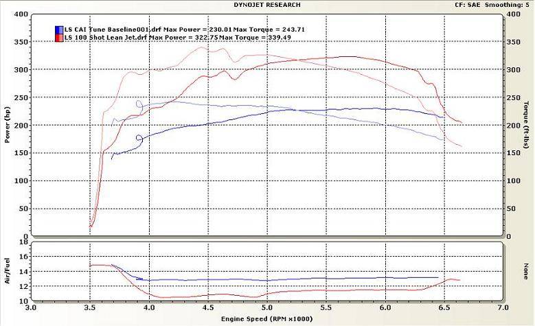

Well here is an update for you all. Just wanted to tie up the loose ends for some of you asking questions on, "What happened to Rocket's 12 second LS project?".
The dyno read low from baseline to the last run. The car is really putting down closer to 350rwhp and 365rwtq SAE in actual. Enjoy...

Not bad at all. The 100 shot of nitrous seems to be quite a bit. I'm not an expert in N2O but how does that affect the internals? I'm assuming you can't use it all the time but giving it increase HP by over 100 HP is impressive.

curious why the "curlycues" in the baseline run.... never seen that before... how did you pull timing out?

The dyno operator (monkey) pushed the log button before he punched the gas and the TC unlocked for a millisecond and then relocked. That is what it looks like on a dyno graph. Once the TC unlocks and then starts to relock the power spikes and then the rpms start to go down a bit due to the load being put back on the drivetrain.
Pulled timing with an Xcal2. Pulled 3 degree's from 3000 rpms on up.
Also, the reason why the graph is somewhat wavy till 5,000 rpm's has to do with the progressive controller. Nitrous solenoids only have full open and full closed functionality so to get 50% power out of them and ramp it up the controller pulses them at 14 times/second (14hz) or however often is desired for them to be pulsed at. How long the solenoids are left open between the pulses depends on the percentage of power wanted. Very similar to adjusting pulsewidth on a cars injectors in a fuel injection system. The progressive controllers have a hard time in the middle between minimum and max power so that is why the waviness is there till 5,000 where its programmed to hit full 100% power.

who tuned the car?
not to sound like a jerk, but that isn't exactly the smoothest incline I've seen and the Air Fuel is a little wacked. It's safe being less than 12.0, but it's still all over the place.

I tuned the car. The reason the A/F's were all over the place is because the way the progressive controller ramped the nitrous/fuel shot. If I raised the HZ (pulse rate) of the solenoids then the power and A/F's would have smoothed out a little bit but then you run into issues of the solenoids having a larger propensity to crap out. Just the way the progressive controllers work with nitrous.

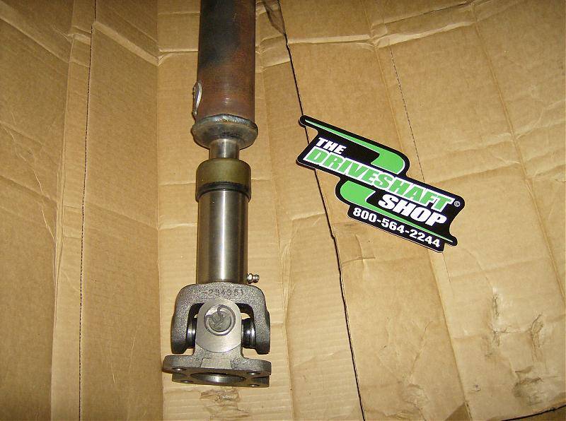

^^ looks good 02asdfghjkl;'
(i was gonna say nice shaft )

how in the world did your power curve make a loop...seriously, someone explain this...there is a loop in the dyno graph...wtf?...boggled...

Refer to post #10.
