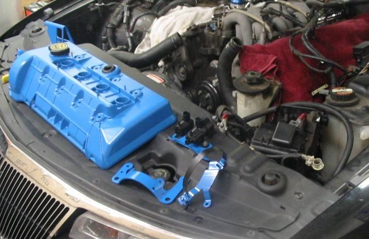

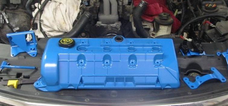

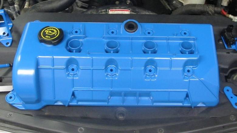

I've decided to clean up under the hood of the MarkVIII while its kinda apart doing some stuff. I pulled the cam covers to gasket them and also am thread-serting all 8 spark plug holes, 1 popped out, other 7 are the preventative maintenance. Doing some misc. other things too. It just seemed like a good time to unbolt things, get the leaves out, wipe down and clean up everything. Haven't really gotten to the cleaning part yet, just unbolted a good part of it. Also painting up some things to liven it up. Thought I'd share some pics of the work in progress and start a thread to post pics as it goes.
Posted by: torquemonkey
The paint job looks flawless! Good job!
Posted by: Sergmark
Looks Good But why baby blue....

Nooo, thats Ford Blue. Or at least one of them, my favorite one. Paint all my motors that color.

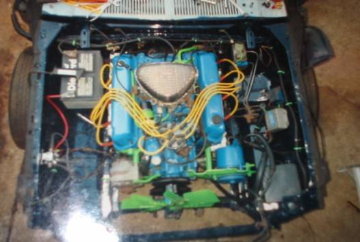

Posted by: Frat-man-du
Big blocks -1966 - late 60's were the lighter blue -70s were the darker blue. 64-65 were black block with gold valve covers & air cleaners...if I remember correctly.

The windsor blocks/small blocks in the late 60s-70s were mostly this color although some of them did seem a slight shade darker. Some were the real dark blue/purple color, but I think that was mostly in the late 70s shortly after the Modified engine came out, Windsors started getting the dark paint like the Modifieds. The 351W from my brothers 77 Club Wagon Van was positively this color, he had it from just a few years old, I painted it when it went into my 76 StangII 10 years later. You can see in the second pic the valve covers weren't painted yet, and the paint color matched. Liked it ever since.

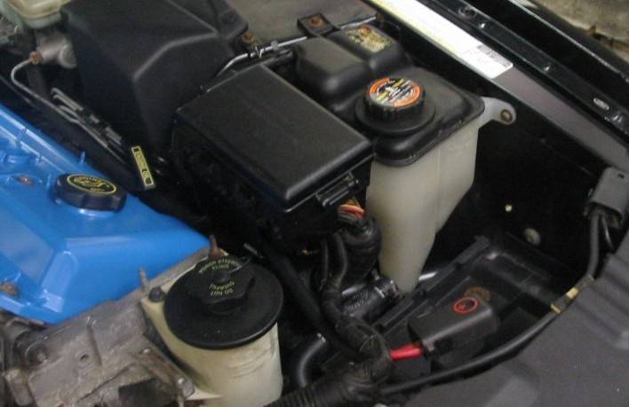

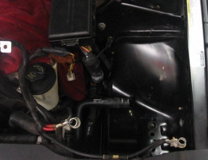

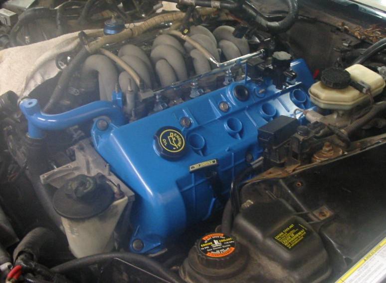

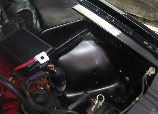

Cleaned up the drivers side firewall, at least to the back of the strut tower. Unbolt, clean, bolt back on, nothing to exciting. Its nice to see it all dirt free and all.
Posted by: 02LSE96LSC91SE84TC
Thanks, and thanks everyone for the good comments. The Ford blue doesn't look so loud as it is coming together.

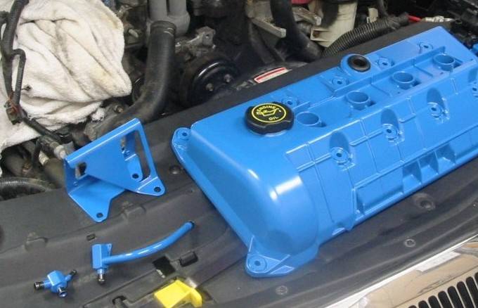

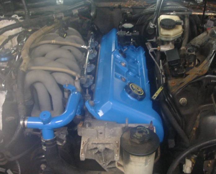

Removed most of the front of the motors pulleys, brackets, and water pump. Cleaned the front of the engine as well as the fan and most everything in that area. Had to repaint some parts as I made the mistake of using some old paint from who knows when and come to find out some parts turned out a slightly different color. Have to clean most of the passenger side firewall area and along the back, but should go faster than it has. I have another busy work week and I have alot of other stuff going on, thats why its taking so long. Slow but sure. Heres a few pics.

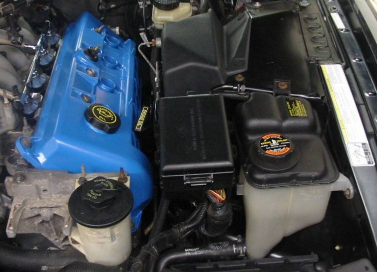

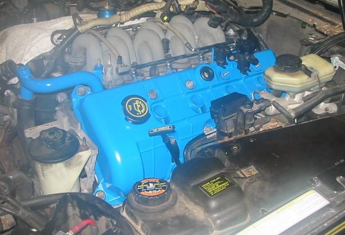

Got a little more done. Still have do the passenger side clean up and around back. Have to clean up the vacuum harness before reinstalling it. I have to wire the Mezeire water pump yet too. Not much left actually. Heres the lastest pics.

What are you doinging with the air intake tube are you going to paint that also?

I'm going to shave the intake tube nice and neat and paint it Blue also. The CAB will be satin black to blend with the firewall.
Seriously Rich you could handle this, nothing to complex at all. Getting the covers off is abit tight, but not that bad.

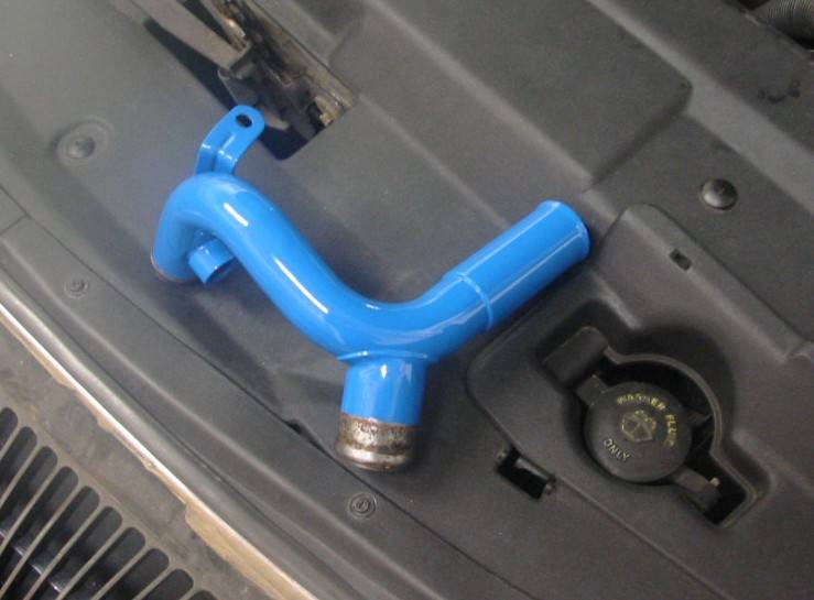

Got more cleaning done. Vacuum harness is on. Started shaving the intake tube. Gettin there.

See...

Its just your basic engine paint from any old parts store.
Dupli-color engine enamel to be exact, the 500degree stuff. The prep is what makes it look good really...that and I've done quit a few things with this paint over the years so you get pretty good at how to lay it on.

Sand away.
Shaped the bondo with 80, then 120...prepped most of the tube with that. Few coats of primer more 120, then 150...more primer. Wet sanded 400...primed and said F**k it good enough. 3 coats of Blue.

Finally...done for the most part.
Just have to wire the water pump and I have a new Cold Air Box idea I'll be making and installing.
I did the spark plug wires different than before, I didn't like the wide spacing of the original ones I bought, these are the stock looms.

They make tons of different kinds for the COPs as you probably know. If you really liked them you could do the 96OBD2 and skip the COP.

I like how you moved the plug wires back Did you have to buy different plug wires?

Nope same ones as in earlier pics, just look alot different when loomed tighter. They are Ford Racing 9mm. Oddly all the writing is faced down.
