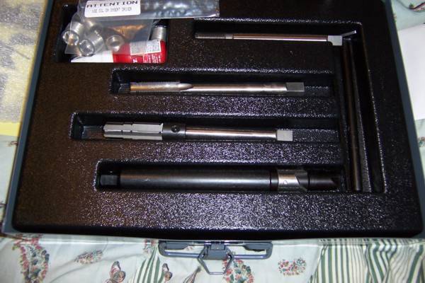

Blew 2 sparkplugs out of my heads last week, and just now got the kit to fix em. 400 Bucks later, I'll be able to enjoy my 98 again.

When this 1st occured, I was gonna pull the heads off, and do (what I thought ) was the right thing, and helicoil them off of the car. I went so far as to order a set of cam holding tools from OTC.
I got online the night after I got the tools ordered, and found this kit. It's gonna allow me to fix all 8 holes PERMENATLY, and not remove the heads. I figure it's gonna save me the cost of the head gaskets, head bolts, and my labor to do it.

Was it $400 for just what's in the pic? or for everything you do, and don't need now... LOL

Yes...400 for what is in the picture only. The cam holding tools were 225. I figure with my 3 VIIIs and my buddy buying stradogs car, I'll need every specialty tool for the modular engine I can get.
EDIT......
If ANY of you come across the need for any of my tools, I would be more than happy to loan them out...(with a deposit of course). Since I have this tool, all you would have to do is...order the inserts to go with it, and you could be all fixed up for next to nothing.

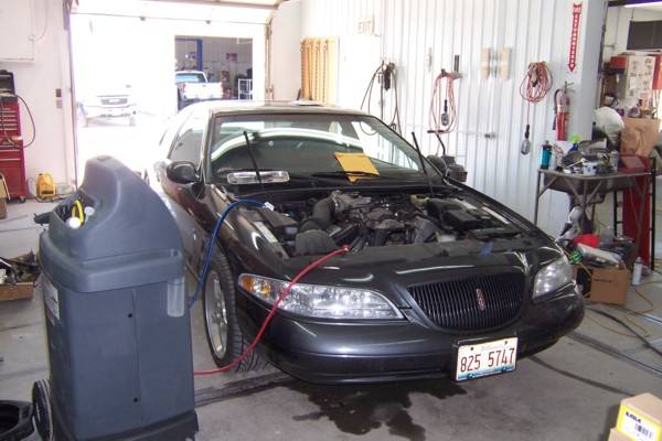

Posted by: 94m5
Got a few things done actually,
Oil change, ac system repaired, and charged, and the obvious sparkplug holes. I really wish I had more time to do stuff to it, but the 95 is getting everything I have at the momnet. The 98' will have to keep it's day to day role for a while.
Mike

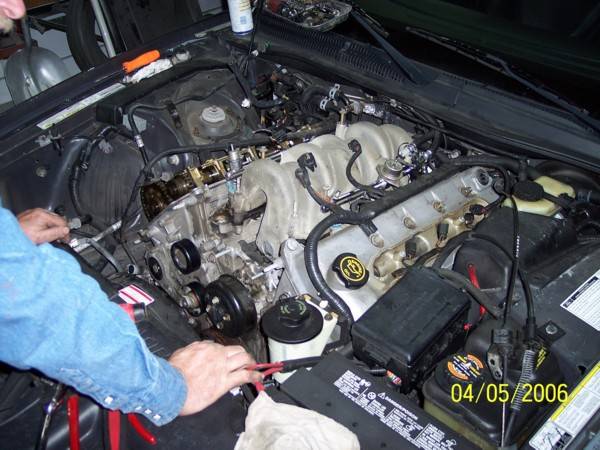

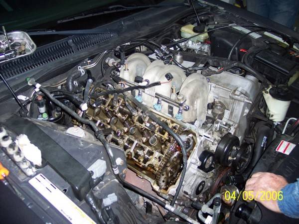

Well I took it apart today. Kinda a PITA to get those valve covers off. Over all it didn't take to long. Rob (rocket5979) came up to help, which speed it up, and the extra set of hands to hold crap out of the way and finagal them out was helpful. Going to need those tools now.
Posted by: 94m5
PM sent,
BTW, this is something that you do NOT need to pull the cam covers for. The tool is long enough to reach down. Infact, I would put the covers back on to keep filings out of the engine.
Mike
Posted by: 02LSE96LSC91SE84TC
Now ya tell me....JK
The drivers side was leaking into the spark plug wells on 6&7. So I figured I'd do them both. The thought crossed my mind that it could be done with them on, I thought it might be easier with them off. I'll take the advice and button them up before doing it.
Well started this process today, not that hard to do but far from fun. First one took a while with a little second guessing myself on how far to ream. Second one went alot faster.
Alot of my other plugs were oddly loose, hmm, all eight are getting done for sure. As I said before when I changed the plugs after getting the car, they were all so frickin tight I knew there would be problems down the road. I could tell the threads were pretty beat, now that I see how few threads there are to start with, well it was just a matter of time. I imagine I had some minor compression loss on a few cylinders for a while now.
You had 6 inserts Mike, I'm going to install them up today and tommorrow. I'll order more Monday, finish up and restock ya.
