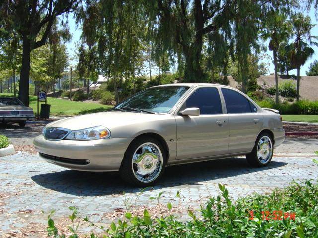

I have a 99 Mercury Mystique V6. It has 127,000 miles on it and recently the CEL came on. Also, I did notice that the acceleration seams kind of bad, at least not as good as it used to be. I had a guy at the shop check the codes and he said that the CAT is dirty, I need a new one. I did call a muffler shop and they estimated $475 for a new one. That's kind of high.
My question is, if I remove the CAT and put a straight pipe instead (I know it's against the Smog regulations, but I don't wanna spend that much money on it right now) will it be safe for the engine? And what will the effects be? More power? Is it gonna make a lot of noise?
