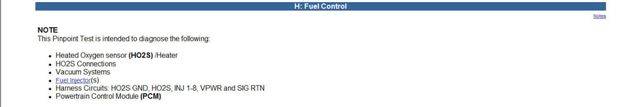

Posted by: eL eS
ahhh fuel injectors... Looking a the PP diag
Posted by: eL eS
I know that more then enough folks have had Fuel INjectors with poor pulse width. You could easily end up with a rich or lean condition.
