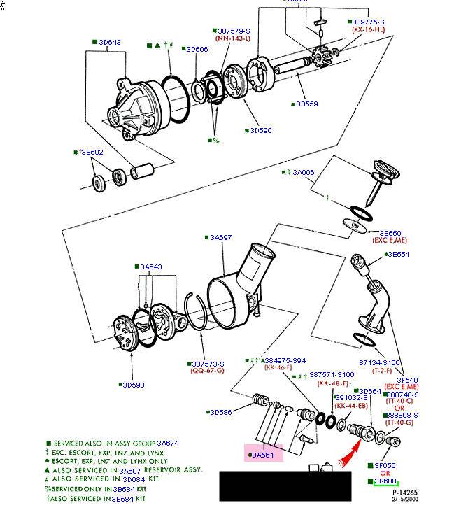

Posted by: TeamFord
This is the best thing I could come up with. I checked all the regular #'s for the pressure swtich but nothing. So I think this may be it, see the highlighted part #.
