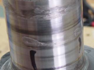

I got 2001 DTS with the same vibe....I think I found it....
Been having a problem with the front axle. 6 months ago tried to replace....but could not get the hub out of trans.
Yesterday, had new axle and axle shaft puller here. Got the axle snub out of trans. Snub has very strange wear. (see pic)
I think in this car the trans shaft bushing is gone. The bad news is this bushing is not available.....you have to buy the complete case extension..... plus select washers etc....mess...
So the new axle is in. It was a slightly different part. Noticably heavier on the transmission side.
Now the vibe is worse with the heavier part....ahhhh.....clue.
Got this theroy from another post on net....similar GM FWD vibe issue...
"The bearing/bushing/case in the trans axle, where the axle enters, was worn and the axle was loose.
At high speeds the axle would bow out at the inner CV joint (run in an elliptical fashion).
This whipping effect caused the vibration."
I think this is exactly whats going on. Please note the damaged bearing surface on the snub. (see picture)
I can pry on the axle snub and it moves.
My car is going in for hail damage this week. So the trans will get fixed next week.

Posted by: Logandiagnostic
The tires on my 2001 have been Hunter road forced balance.
My vibe also comes and goes. It is obvious from the picture the axle is causing the vibe on my car.
My car is fine up to about 64-65 mph. The theroy is at that higher speed the worn bearing/ half shaft kind of launches into critcal mass....it goes where it wants to go.
It is pretty easy to check how much loosness is in the hub. With the car on a flat surface....simply pry on the inner axle hub....you should have very little movement.
If the axle is parked on a incline or anything that loads the axle up. You will not see the looseness of the axle bearing.
I have heard.....the early cars used a babbit shaft bearing.....latter cars used a brass bearing....mine has metal to metal transfer on the axle snub. I have not confirmed the babbit /brass bearing issue yet....
Posted by: Ron
When I saw the picture of the axle I got scared more than a little.....
