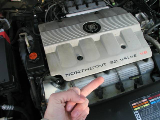

Posted by: Redwingvksm
Just found this pic in another thread - and I HAVE to post it here..
Posted by: pepperman
You think he likes the NorthStar
