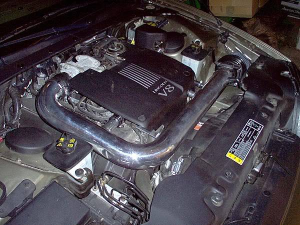

Posted by: Beamer
Not really a coupler, its like something you'd use to hold two plastic pipes together and has a clamp or two to tighten and hold 'em in place.
You can kind of see it in this pic where you are having your problem.
Posted by: Midas78
Great, THANKS!
Posted by: Beamer
Glad to help, I heard you can force it in w/ some type of lube but I was not about to do that cause I was not sure since I thought it could harm something. But if you to a hardware store or a place that has Ferncos and ask someone I'm sure they'd know what you are looking for.
Posted by: J3FF
HEY!! You just solved my biggest problem...you are talking about the hose closest to the throttle body right? So it's a fernco? Do you just push it in and then wrap the fernco around it?
