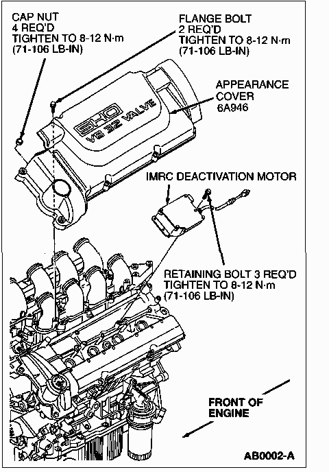

here is a pic of IMRC dosen't look that bad to do ?? just guessing
