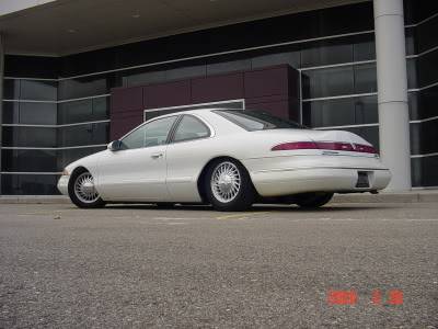

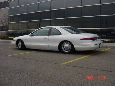

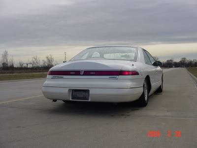

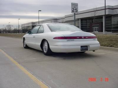

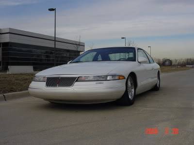

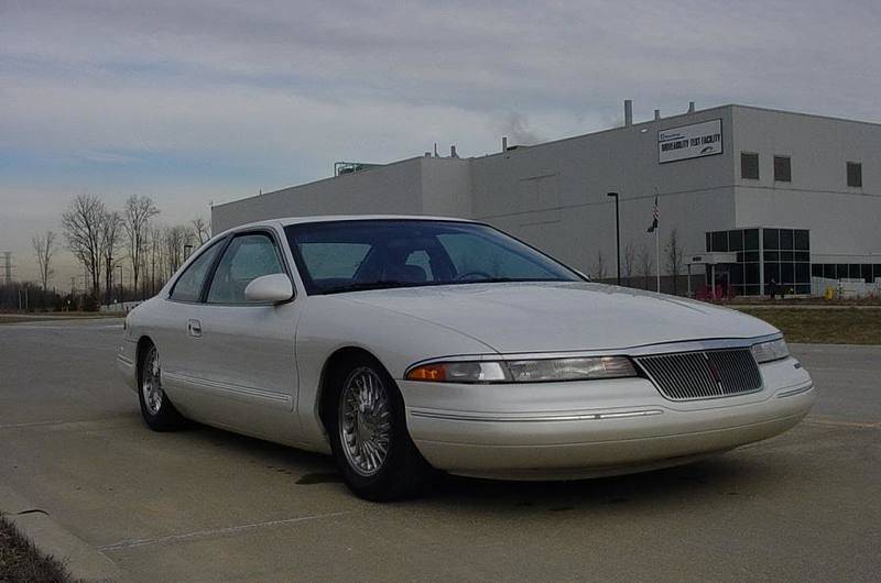

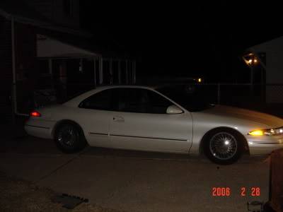

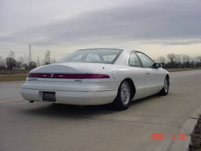

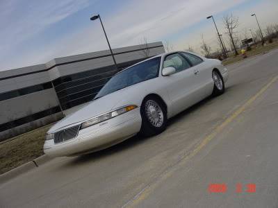

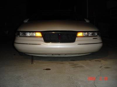

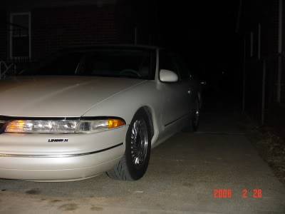

Here are a few pics of my car cleaned up and dropped. Some of you may think that these kits are hard to install, but on a scale from 1 to 10. Id rate this a 2. 10 being the hardest. The most difficult part of the install was getting my hands and tools into the tight space under the glove compartment. Also getting the t-taps on the wires while they are very closely located makes it frustrating. I get 10 times more stares when im parked or pull out of a parking space. This kit is definitely worth the $35 or $42 depending on which kit you buy.
