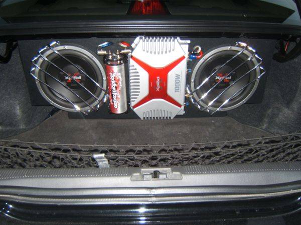

Posted by: Quik LS
Some 'small' changes....
ICE:
• Sony Xplod Amplifier XM-2165GTX 1000watt amplifier
• Sony Xplod 2 x XS-L1200B 12" subwoofers
• Handmade sub-woofer custom enclosure
• Alpine 6CD in-dash 180watt head unit with Audiophile 12 speaker option
• Rockford 1 Farad Digital Capacitor
• Alpine SPS-570A 2-way door speakers
• Fosgate Rockford FRC3203 - 3.5" Punch 2-way console speakers
• The PIE FRDN-AUX Auxiliary Input Converter adds standard RCA jacks to CD2 input on the Alpine head
• 4Guage wiring, 150amp fuse kit
• Dell C400 Computer mounted on rear seat
• 8” LCD monitor
• Wireless remote
• AutoEnginuity OBD II Scan Tool and Dyno Software Realtime Display
