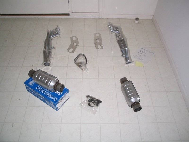

New pretty exhaust that you’ll never see. Kooks mid-length, extra long 02 sensors, 2.5 cats.

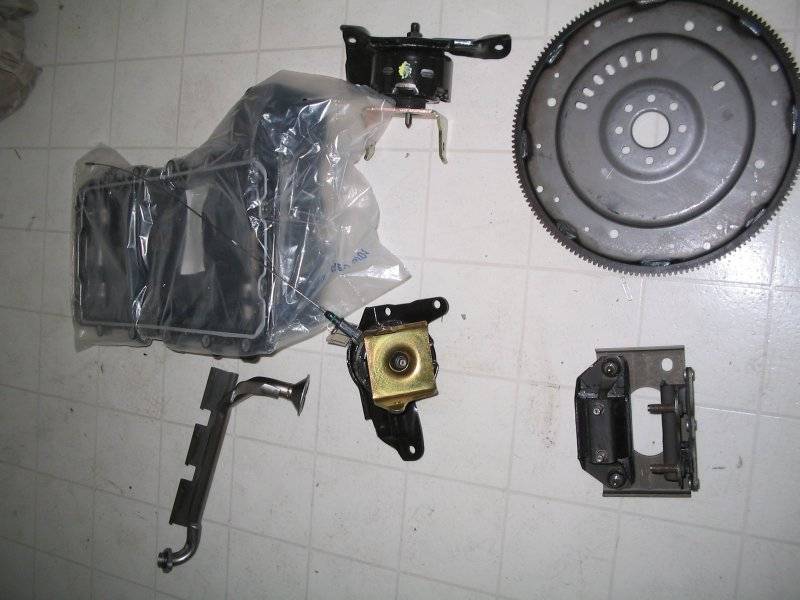

new ford parts. Flex plate, stock motor mounts, mark viii oil pan and pickup.

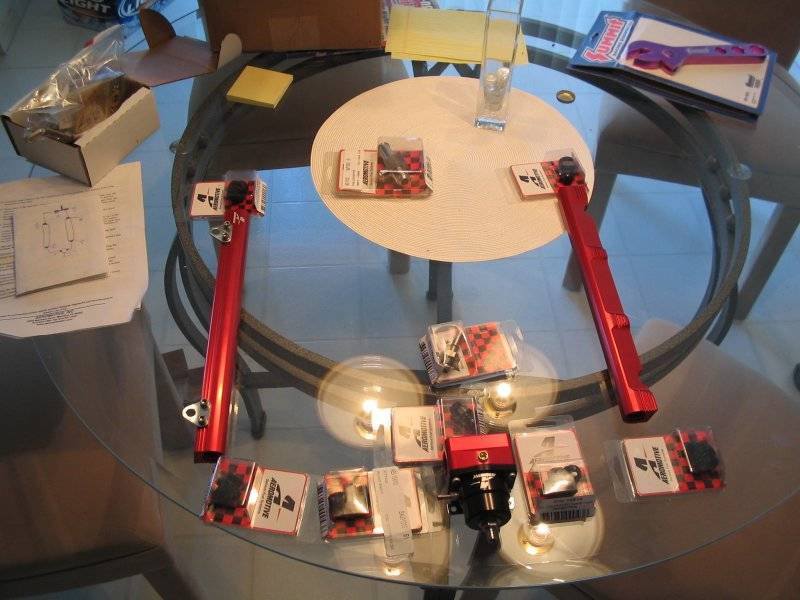

aeromotive return fuel system & regulator

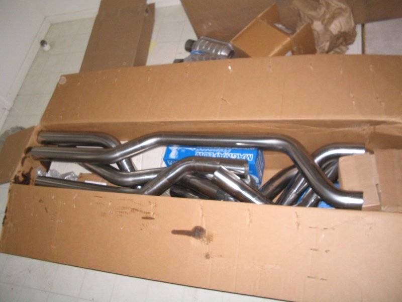

Stainless steel exhaust pipes

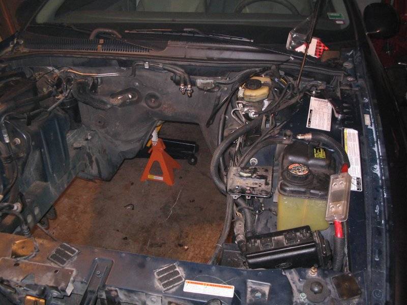

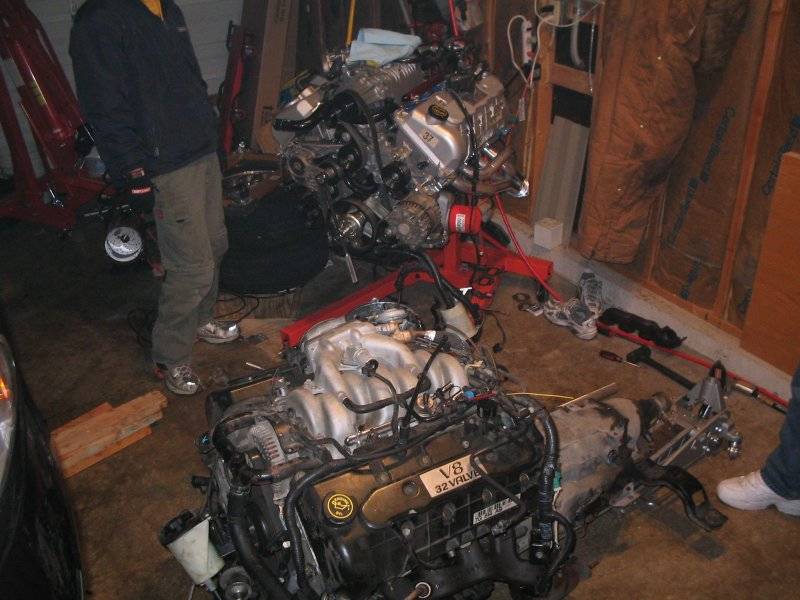

was it easy getting the engine out? it looks like you had to take it out from underneath?

I've taken about 10 motors from the top, and never from the bottom. looking at it I was determined to take it from the top again but I have some brackets to fab up so I needed a clear view of the k-member so dropping it was going to be the best way. on a scale of 1-10 I give it a 7 for difficulty but it will go down to a 5 or lower after i've done it a few times. Its just so many things on this car and this engine that make it hard but in the end I think I'll do it from the bottom.
I had some good friends over that has droped the k's many times before and that made it easier I look at the drop if I had to do it alone and it would be 7

Are those stainless steel exhaust pipes pre-bent for the mark viii?
Posted by: phreakness
Quote:
Yes
