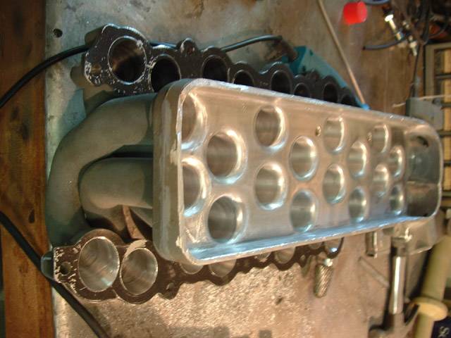

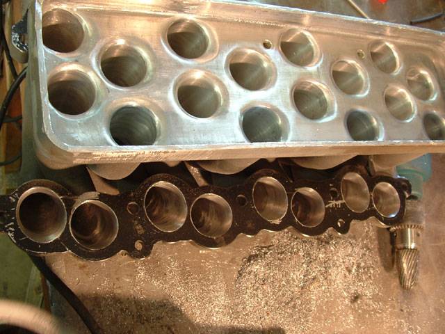

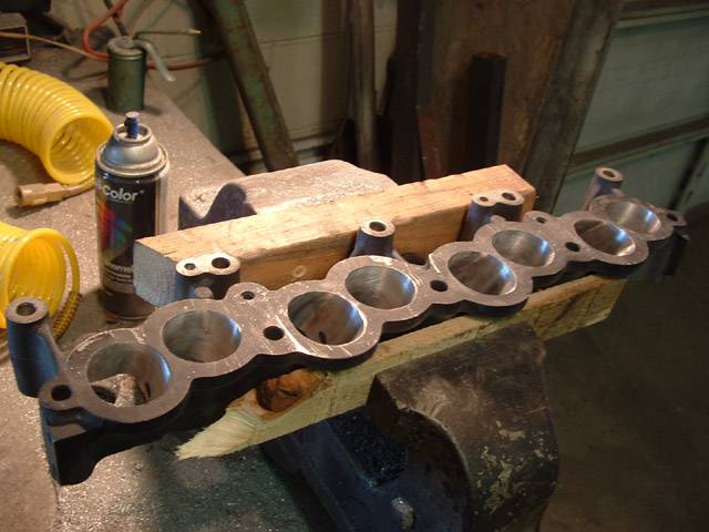

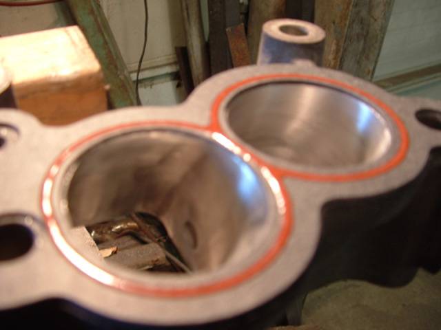

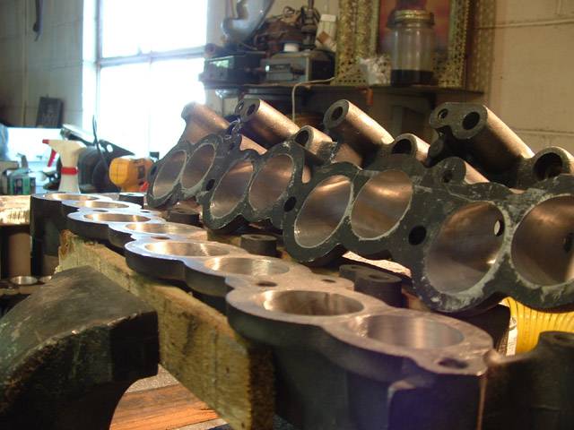

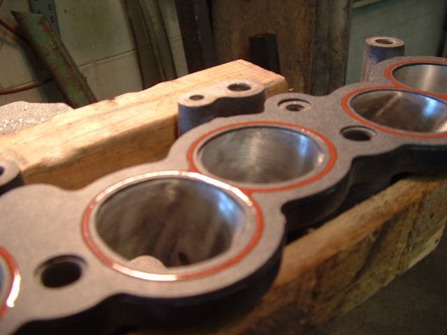

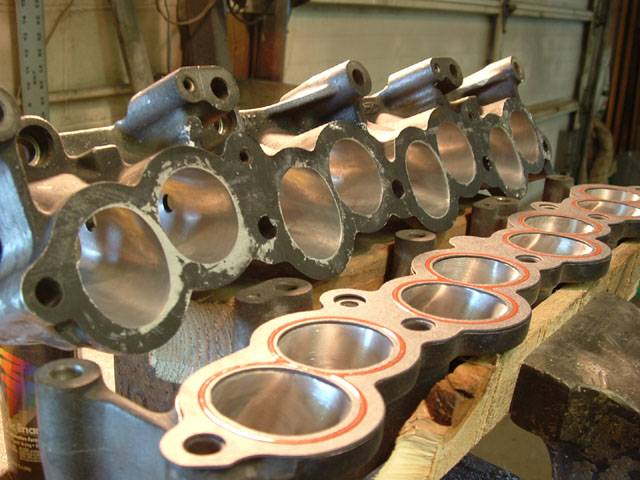

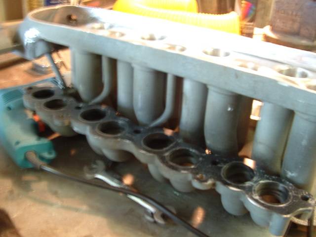

Here are a few pics of the intake I have sitting on a shelf in the garage. I need to get the IMRC's welded shut, but other than that, it's done. I would like to do a short runner setup on this, but the time required is too great. (I would rather work on a cobra intake and be done with it.
If you want this intake/IMRC setup to continue on, 75 bucks+shipping and it's yours. I am TOO damned busy to even think of working on it, and would like to see it go to someone that could use it. It's pretty much as you see it there, except the bottom of the intake has been TIG'd back on.
I have to agree with the previous statement that you would gain 15-20 HP up top, but would suffer from lack of torque down low. 4.10's would alieveate that loss, and a stall would help it out even more.
