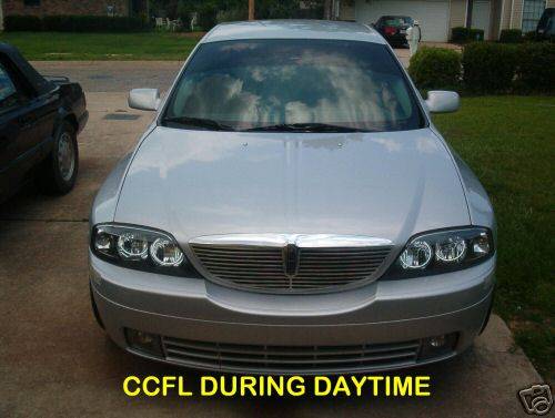

90% of lvc members have their LS cleared. Check this pic out:

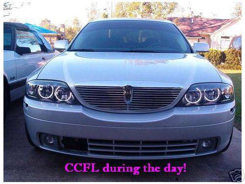

Some of us have angel eyes too:

Another pic:

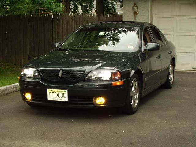

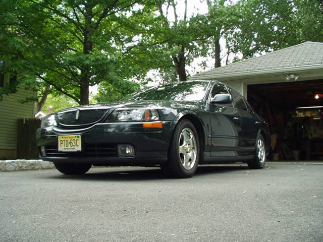

To answer the original question, swapping the pre-03 headlights for '03+ headlights is possible with some minor modification. If you do a search, I'm pretty sure that one of us who has done the swap wrote a how-to. All that's really involved for the swap is changing the headlight mounting bracket and a few simple wiring modifications. The whole project took about 2 hours, and the HIDs are awesome at nite. Here's some pics of mine.
