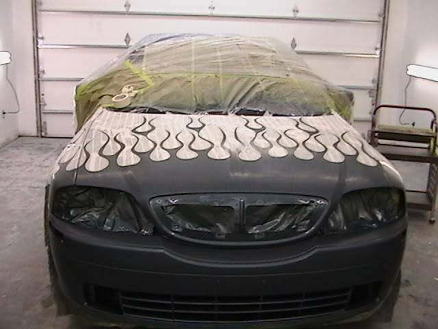

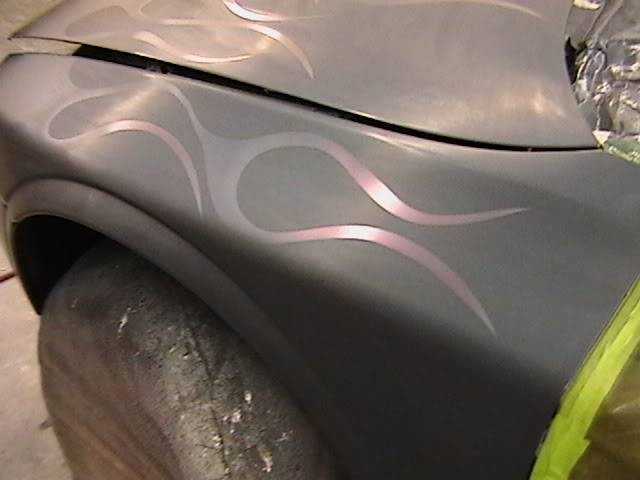

Got some pics of the flames being put on my car.

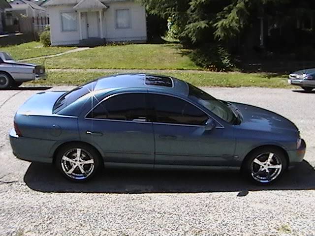

Before

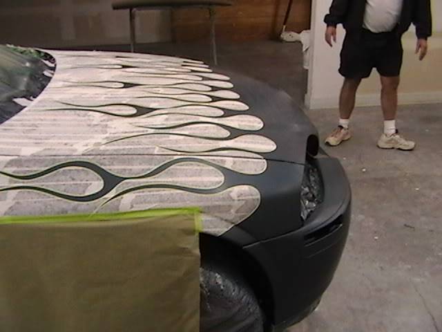

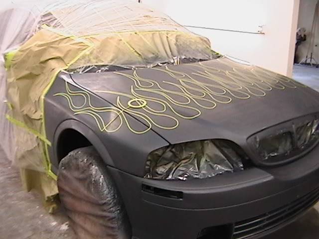

Taped on
Back Taped

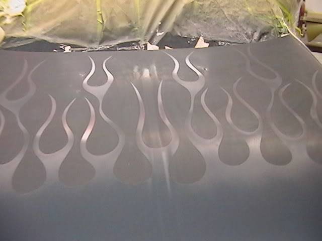

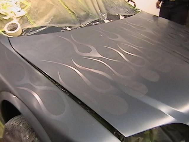

Sprayed
Clear coat tomorrow and the wet sanding and buffing on Wednesday.
More pics to follow.

Not bad, personally I wouldn't go with flames on a luxury car, but they look good so far. I take it you are repainting the whole car, what color?

What most people do not know is that ghost flames are nothing but pearl mixed into clear coat. When you are shooting pearl, you cannot see the colors you are spraying. There is an unwritten rule about spraying pearl. If you can see the color, you just put too much on. So as the painter is spraying and trying to blend the different colors of pearl, he cannot see where one color ends and the other begins. It truly is an artform. That is why flames like this normally cost $2000 to $2500. you only end up about $300 into the materials, the rest you are paying for time and talent.
