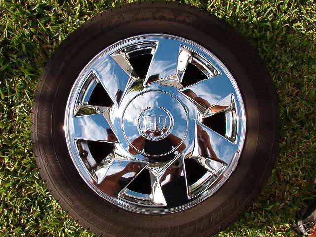

I just purchased the all Chrom 17" DTS Wheel pictured here.
I plan to put 255/50/17's on it... I was going to goto 18" but like
the stock look. So, bought the coolest OEM wheels they have.
Got a decent price too... Under $1K with shipping. I may keep the STS wheels
on until Spring... No need to mess up my wheels through the Jersey Winter!

P.S. On the wheels.. I bought them from GMPARTS on Ebay. The yare 100% OEM GM Stamped! I too found only a few 5x115 that I really liked. I checked out the 18" STS wheels as well.. Besides wanting a fortune, it just didn't do it for this car. I have seen pictures of the '02 17" DTS wheels that I pictured below. Car looks awesome with them.
