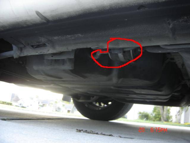

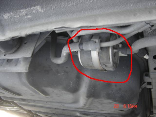

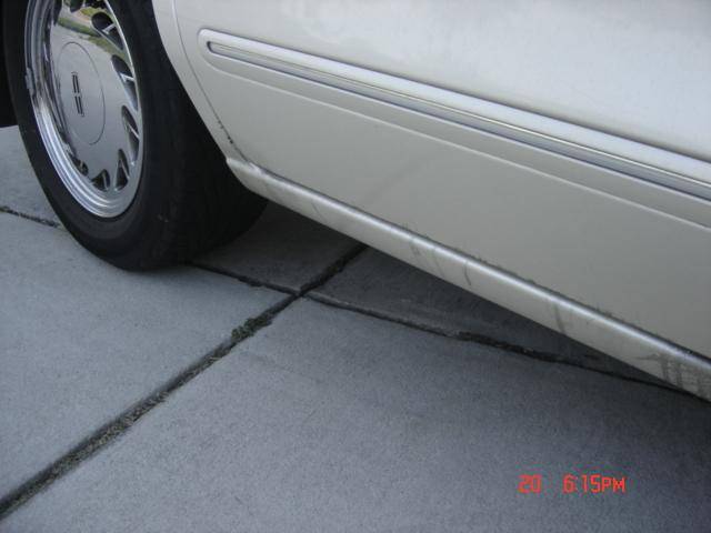

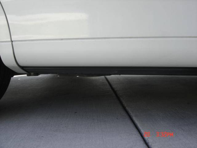

Here is my TC. (have it at home right now, Will give you pics of the conti soon)it is almost the same place as conti's but the fuel filter is a little thicker of the conti. see if you can find it.
Posted by: mark0101

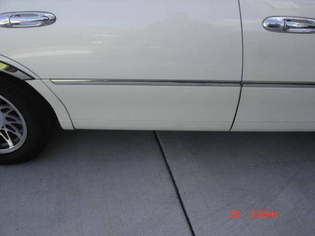

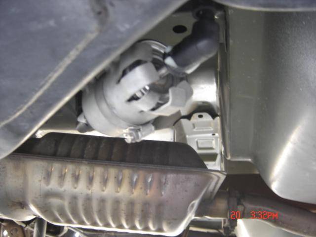

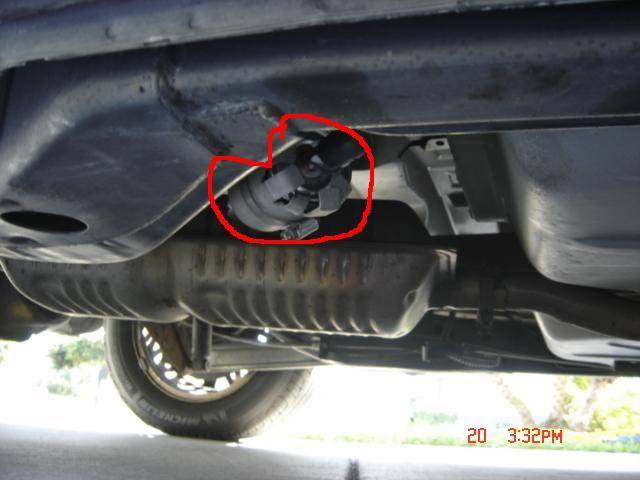

here is the conti
