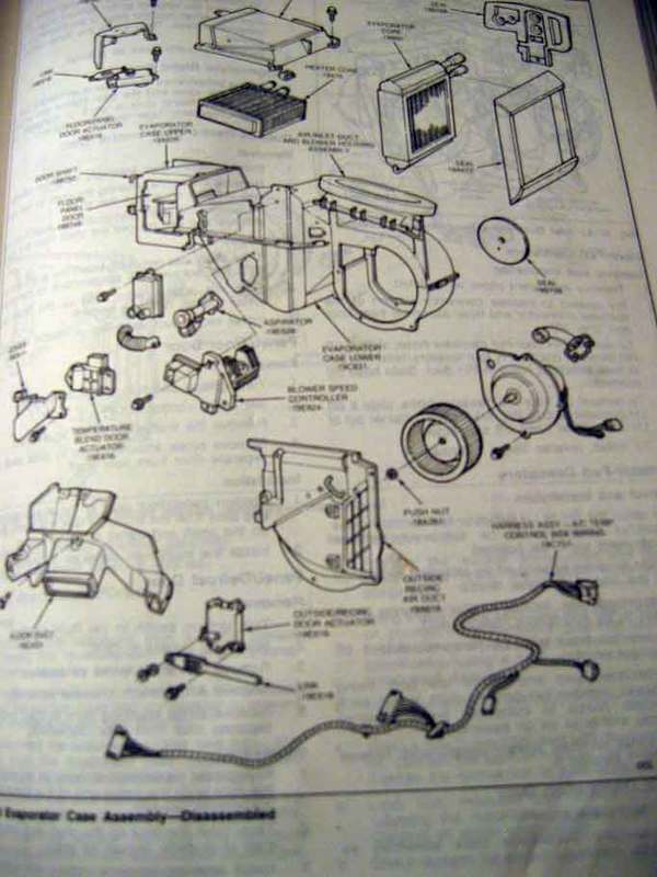

Here's another heater core replacement guide.
http://www.lincolnsonline.com/article57.html

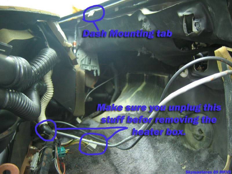

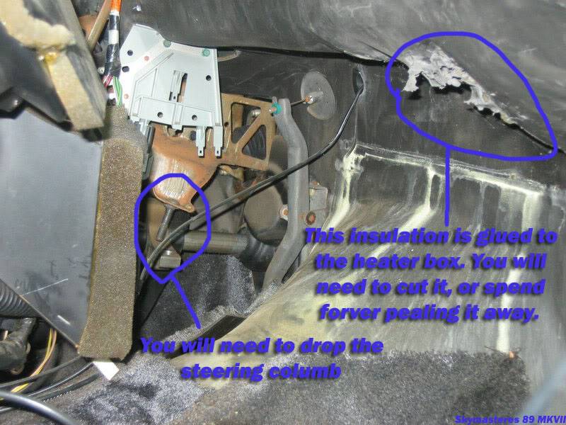

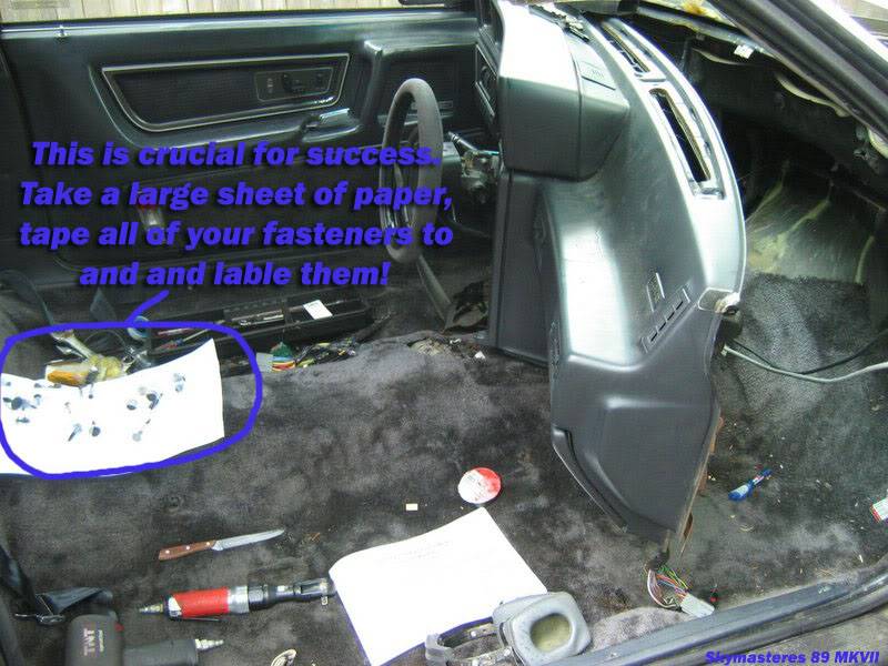

Here are a few images from when I replaced mine, I have more but I have to get them off the camera.
Let me tell you, PLAN on spending a day doing this! Before I started sure, I'll knock this off easy. During, "I'll never do this again". After, "I might do it again, maybe, if I find a MKVII I REALLY like".
Also, if you don't having someone helping you move the dash arounde it is goung to be extreemly difficult to get it pack into place properly. Trust me I know .

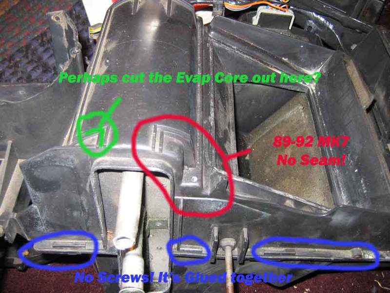

Oh yeah, here are some of the picts of the heater box I posted while I was still doing the project.

Gentlemen, thank you for all the diagrams and photographs. It has been a God send.
