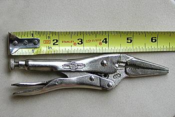

I think these Ladies kicked ass! The anti-theft bolts are unique. One thing that I forgot to add was that I use needle nose Vise-Grip pliers to remove the bolts. When I change the switch in my other 1984, I'll include pictures of removing the bolts.
